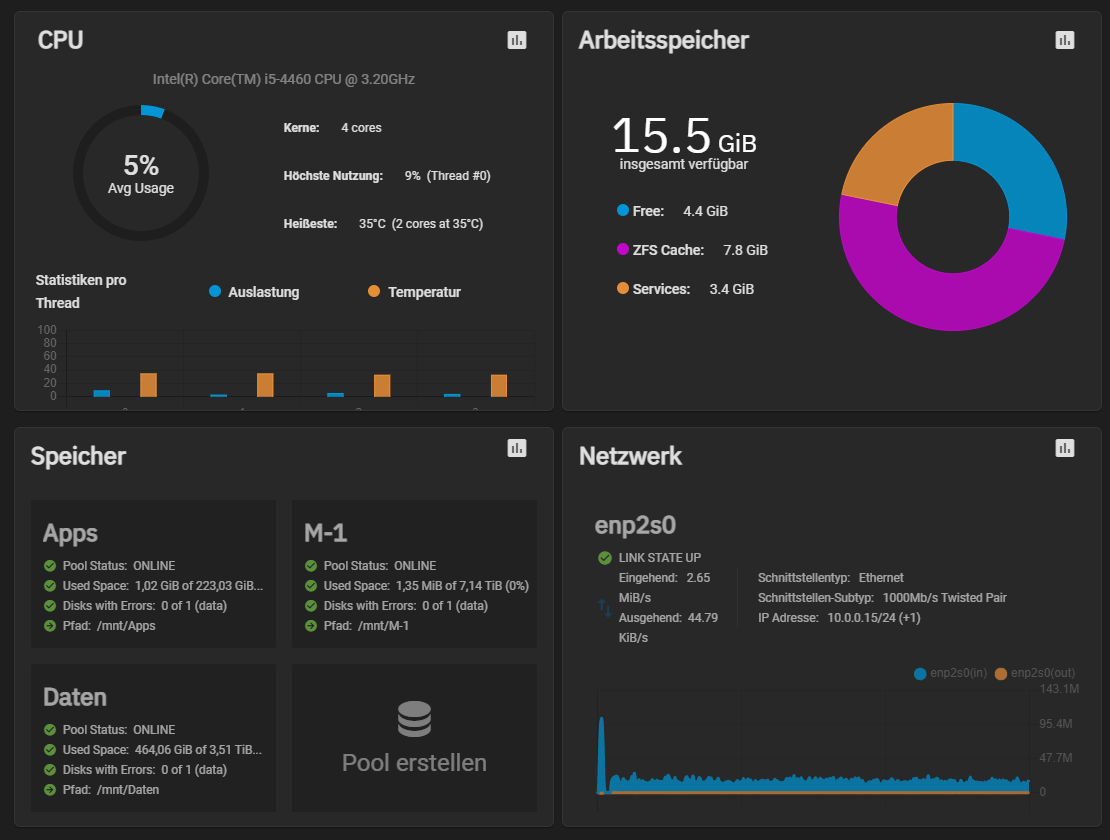

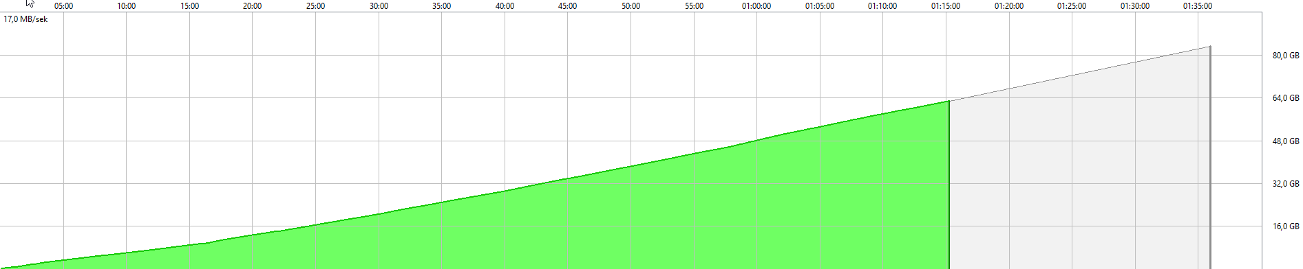

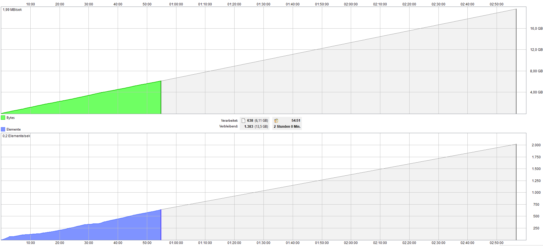

i build a testnas with my old 4 Core Intel 4460, 16 gb DDR3 Ram and the Mainboard MSI H81I.
The Truenas OS is on a USB SSD Drive and the Pool Drives are over SATA.

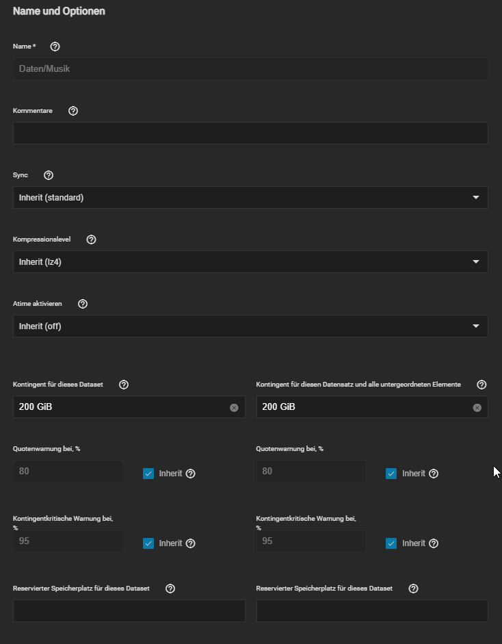

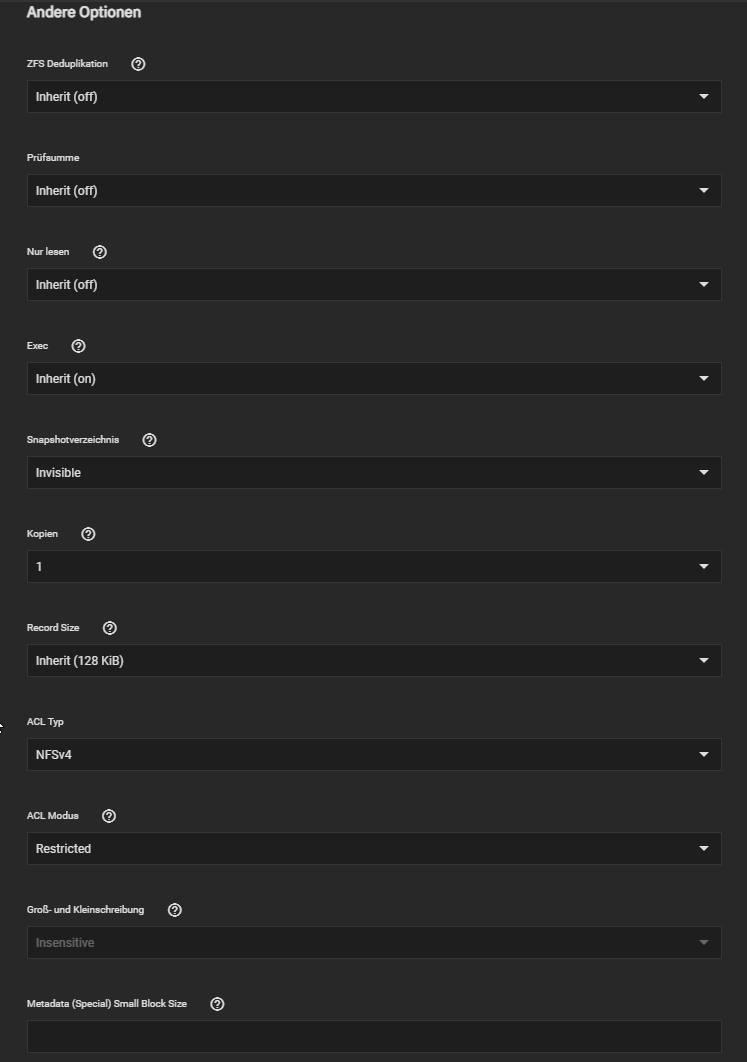

Now i add a pool on a single WD Red 4 TB with 5400rpm and add a Dataset SMB with a smb share and copy some data on the Storage. I enables Compression LZ4, but not enabled ZFS Deduplication. My Write Speed is under 10 mb/s all over the Time with small and big Files.
Source: Linux server
Destination: Truenas Pool
Connection: 1gbit LAN with 1 Switch
No other Traffic at this Moment.
Dataset
I know the HDD can more. In my old NAS the same copytask was over 80mb/s.
how i can improve the performance? May the System Drive on USB SSD is the problem (cache)?
Thanks

dont test with 'copy" - use a write or read test first.
see if its a nas isssue or a copy issue

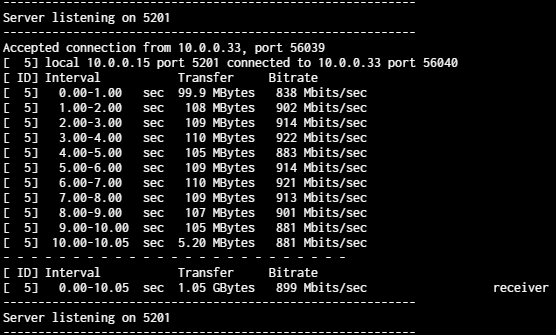

Mainboard MSI H81I.
Yeah, this is a crappy Realtek based ethernet mainboard and is not expected to perform well. The network test you're showing would be typical of Realtek.

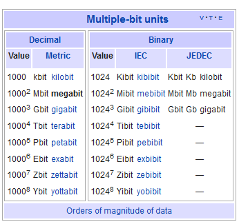

The Networkdevice work well normally. Before i installed truenas, i used this board with Proxmox. The Performance was better than this. I removed proxmox, cause the cpu performance was not so good for a hypervisor.

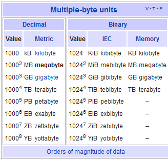

I learned:
mb/s every time is megabyte
mbit/s is every time megabit
Its not ambigous. Look in the Wiki and much other Definitionswebsites:
It *is* ambiguous; nowhere in your listed charts is "mb/s". Capitalization is significant. These are SI metric prefix units. A small "m" is milli, as in 1/1000th, while a capital "M" is Mega, as in one thousand. I also specifically pointed you at the Terminology and Abbreviations Primer on these forums, so I don't really care about your "Wiki and much other Definitionwebsites".
