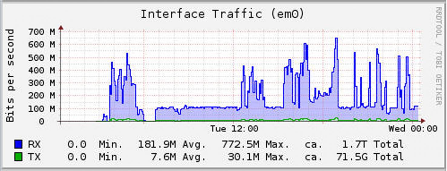

I've had pretty much the same problem trying to initially fill the FreeNAS system from a windows system. I played around with this on and off for 4 days trying to speed it up. That 14MB/s seems to be a magic number. Here's my setup:
FreeNAS (FreeNAS-8.3.0-RELEASE-p1-x64 (r12825)) end:
Supermicro x9SCM-F v2.0b BIOS, E3-1220Lv2 2.3GHz Xeon, 16GB ECC DDR3 RAM, 10 x 500GB RAIDZ2. LSI9211 HBA.
Windows end:
WinXP Pro 32 SP3. Intel DP55KG motherboard. 12GB ram but only 4GB good to XP. 1x 120GB SSD system & pagefile. 2x 2TB HDDs on SATA storage.
Usually connected with a HP Procurve 1810G-8 J9449A switch (1GB/s on all ports). All leads are Cat5e, some are bought in, some have been made by me from known spec cable. Removing the switch (its all static IP) and connecting the Win PC to the FreeNAS back to back (and swapping / changing leads) had no effect on speed. Putting in an Intel 1000PT dual port 1GBit/sec NIC and disabling the onboard motherboard NIC on the windows PC had no effect. The Supermicro NIC on the FreeNAS end seems to behave fine on other systems. Delivering files from the SSD made no difference. Delivering very large 1Gbyte+ files made no difference. I've never seen the FreeNAS CPU come even close to bottlenecking, usually even under load, it's below about 10% CPU.
I think this is possibly windows problem but I can't prove it. Here's my thinking -
Using a windows RSYNC client -
The magic number of 14MByte/s transfer rate appears all the time for me running an Rsync client (in this case QTDSync v0.6.18 beta). Only on extremely rare (maybe 0.01% of the time) occasions will it burst faster (about 70MByte/s) on large files, and why it does it then I have no idea.
Using a windows FTP client.
Filezilla version 3.6.0.2 - This will transfer faster, upto about 50-70Mbytes/sec but has a problem where queueing a lot of files (some say 5000+, or is it 50000+?) leads to it severely slowing down. So I saw 50-70Mbytes/sec to start with while it queued more files in the background, then the speed dived.
Using Explorer or SyncToy with CIFS -
I found CIFS to be the fastest of the the lot for a single service. It will usually managed 50-70MBytes/sec with either a straight file copy or using SyncToy. Microsoft's Synctoy does work very well :eek: and its very easy to set up. Using explorer was okay until it aborted for some reason and trying to tell what was copied and what wasn't, wasn't easy. The aborting was usually down to a windows resource issue but what underlay that error I'm not sure, See below for possible work rounds.

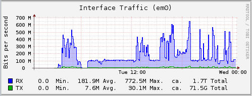

There is a combination that I found to be the fastest of all, providing you have effectively 2 sources of data (ie Data on at least 2 HDDs needing to head towards the FreeNAS system, and thats to run an rsync service to transfer one HDD and then use CIFS to handle the other. Doing this worked very well. The FreeNAS system took it all in its stride. Again I saw the magic 14MBytes/sec figure appearing. If you look at the graph of the interface traffic attached for the FreeNAS NIC , that 100Mbits/sec baseline is the RSync client running. All the Peaks above that are the CIFS transfers. Running CIFS at the same time doesn't slow the Rsync down at all. Click on it to see it bigger.
