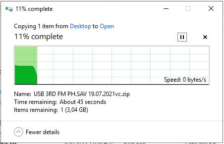

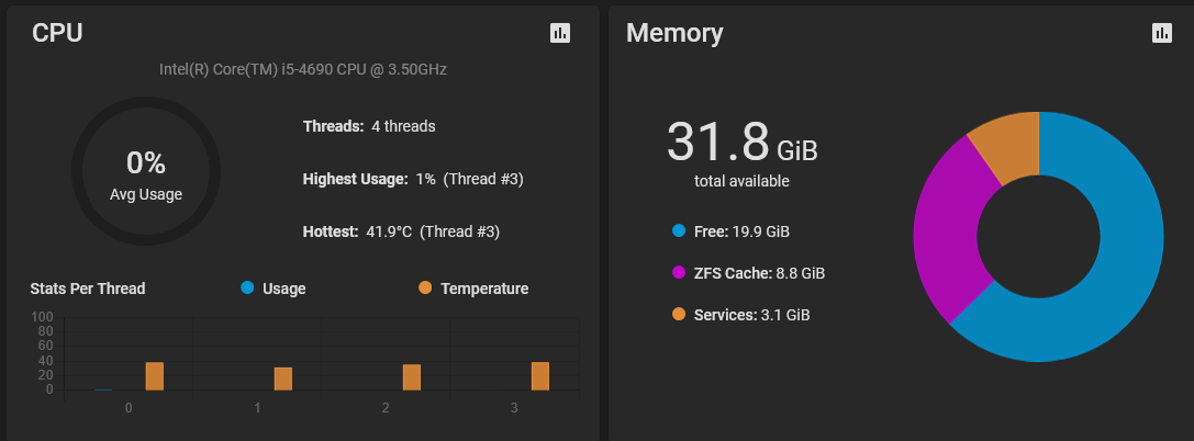

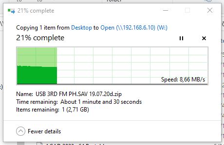

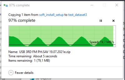

I have same issues with strange behaviour on transfers. sometimes it stacks on 0mb/s for 1-2 minutes and then restarting. Is affecting also the SMB Service which it seems that is restarting.
If it is a cache problem, wouldn't be better to use SSD drives ? for example crucial MX,BX series 2,5" Sata SSD.
I have 2 truenas boxes doing the same strange behaviour, 16 and 32GB Ram, with healthy storage mirror pools with SSD's. Intel network cards also.
Any suggestions ?

ChrisRJ
Oct 23, 2020
1,919
@djb please describe your system in detail, as per the forum rules. Without such information we cannot help you.
djb
Nov 15, 2019
76
Hello Sir,
the system is i5-4690 3,3Ghz 4 core 4 threads. Ram 32GB.
the storage pool is healthy 2Xmirror SSD's Crucial 480GB BX500
onboard NIC is Intel. Truenas Core 12 U8.1
