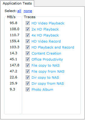

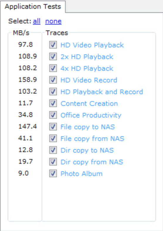

NASPT (run in Win7 VM w/ 4GB RAM)
Pool 1 -
Pool 2 -

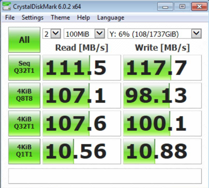

CrystalMark
Pool 1:
Pool 2:

Does anything look out of the ordinary here? My next step is to do some testing from each client to the NAS. Most of my clients are MacOS - does anyone have guides or recommended software to use to baseline/benchmark?
