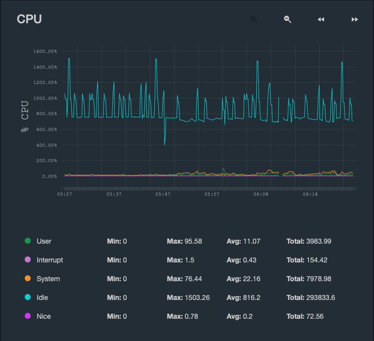

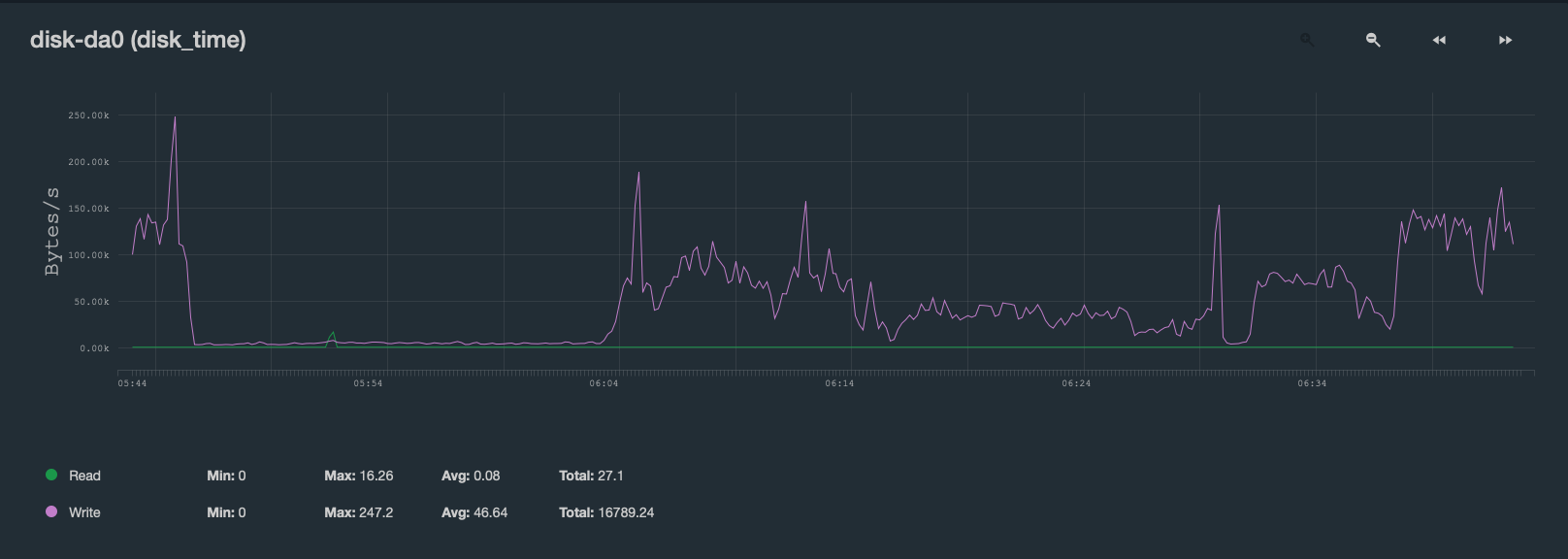

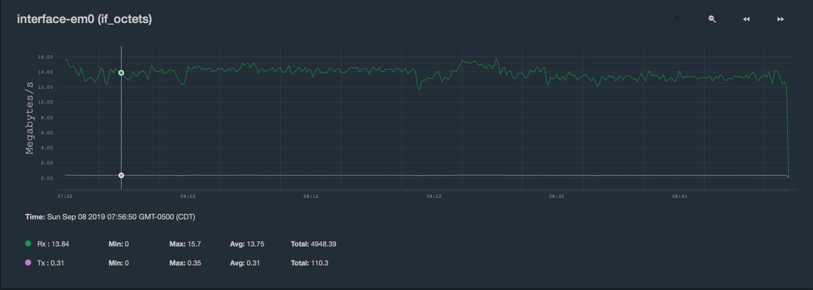

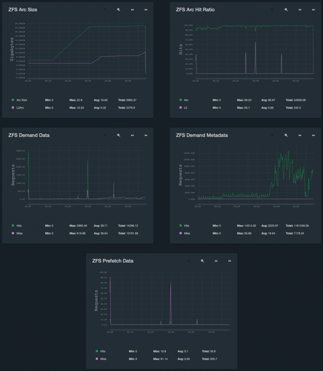

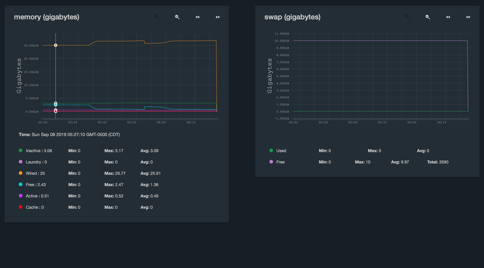

created SMB and AFP share and attempted to copy ~666GB of raw photo's over to the share (not at the same time, indipendently tested each protocol). and the copy is insanely slow, ran fine for the first say 15 min. and then fell on it's face. RAM/CPU/L2arc all seem to be good and running as expected... you can see the attached graph screenshot where the disk just falls on it's face, and it's picked back up, but the est. time to completetion went from like 8hr. to over 24hr.
Network seems fine, both systems are plugged into 1GBe ports on same switch. iperf reports good connection bidirectionally.

see graphs for other stats comming from freeNAS. someone with a bigger brain please explain what I am missing.

Left out was the actual transfer speed... what is it? Mac OS can be wildly optimistic re: transfer time. If I'm doing the math right, I get ~8MB/s, which is admittedly very low. The initial speed of ~24MB/s also seems low given the format being used (large media files).
Are the the ZIL and L2ARC on a SSD? If so, what is the type? I wonder because the ZIL is very sensitive to write speeds under sustained use. There is a reason that Intel can charge the wild prices for Optane that it does...
Another advice I have seen here is trying the same transfers with sync=disabled to see what the raw write speed is. If the speed pops up to the level I would expect (i.e. somewhere around 100-120MB/s) then that suggests a configuration / ZIL / etc. issue.
My system with a single VDEV and a Z3 configuration manages about 120-170MB/s with large continuous writes. This is expected as each VDEV pretty much behaves like a single hard drive. So, your 3 VDEV system should be easily capable of saturating a gigabit connection.
