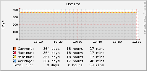

FWIW, I get about 3.2 to 3.6GB/s with a 4 channel 2400mhz system running on Xeon E5-1650v4 (circa 4Ghz boost iiirc)
Guess its time to update it to 11.1 so that I can join the fun with diskinfo -wS
Chris Moore
May 2, 2015
10,080
If you can reboot that after that many days of uptime, it may tell you no.
