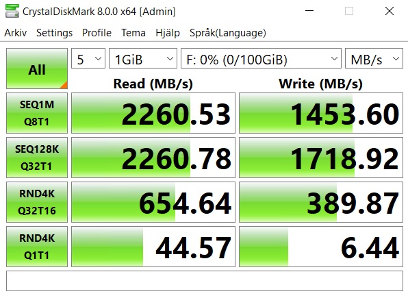

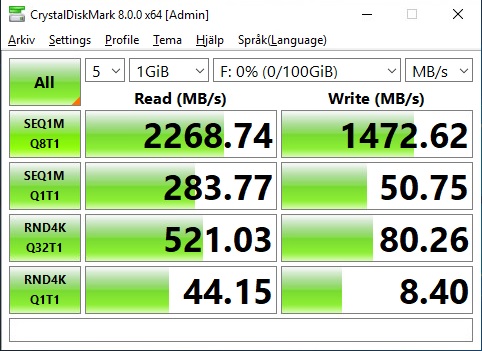

I'm testing a new system and have tried different nvme disks to see what the performance difference is.
I'm not sure if i hit any limits on any protocols, i would like some guidance from the community (beyond the the resources/stickies i've allready read).
The system specs:
Supermicro 1114-WN10RT
AMD Rome 7402P
512GB 3200Mhz RAM
10Gbit NIC (iSCSI only)
With four PM983 disks (1.9TB NVME U2) as striped mirror (two vdevs), exported to iSCSI as 1TB zvol (blocksize 64KiB, sync always) , i get this performance when running it on a VM (only one on the storage).
And with ten PM1733 disks (1.9TB NVME U2) as striped mirror (5 vdevs), exported to iSCSI as 5TB zvol (blocksize 64KiB, sync always), i get kind of the same numbers.
Is this expected? Or am i hitting som kind of limitations?
I wouldn't expect more on the first test, since the link is only 10Gbit atm.
This is just basic tests, i'm still waiting on a dual 40Gbit NIC so i can test multipathing and more, but i was a little bit pussled that there was not more difference between the tests, when the disks are very different performance wise.

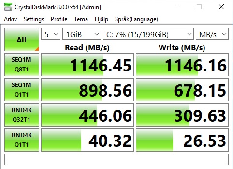

Hey @ehsab,
Reads and Writes are in the range pf 1,150 MB. 8x 1,150 = 9,200 Mb = 9,2 Gb.
Does that points you in the direction you are looking for ?
Did you configured jumbo frames to take you closer to the theoretical limit of 10G ? With multiple NICs, you can configured round robin every 1 packet, so basically using all interfaces at once.
ehsab
Aug 2, 2020
45
Hey @ehsab,
I have not configured jumbo frames yet, that usally never give more then a couple of percent more.
I was more wondering why 1M Q1T1 and RND4K didn't differ more on the two sets of disks.
Seems to saturate the 10Gbit link with SEQ1M Q8T1

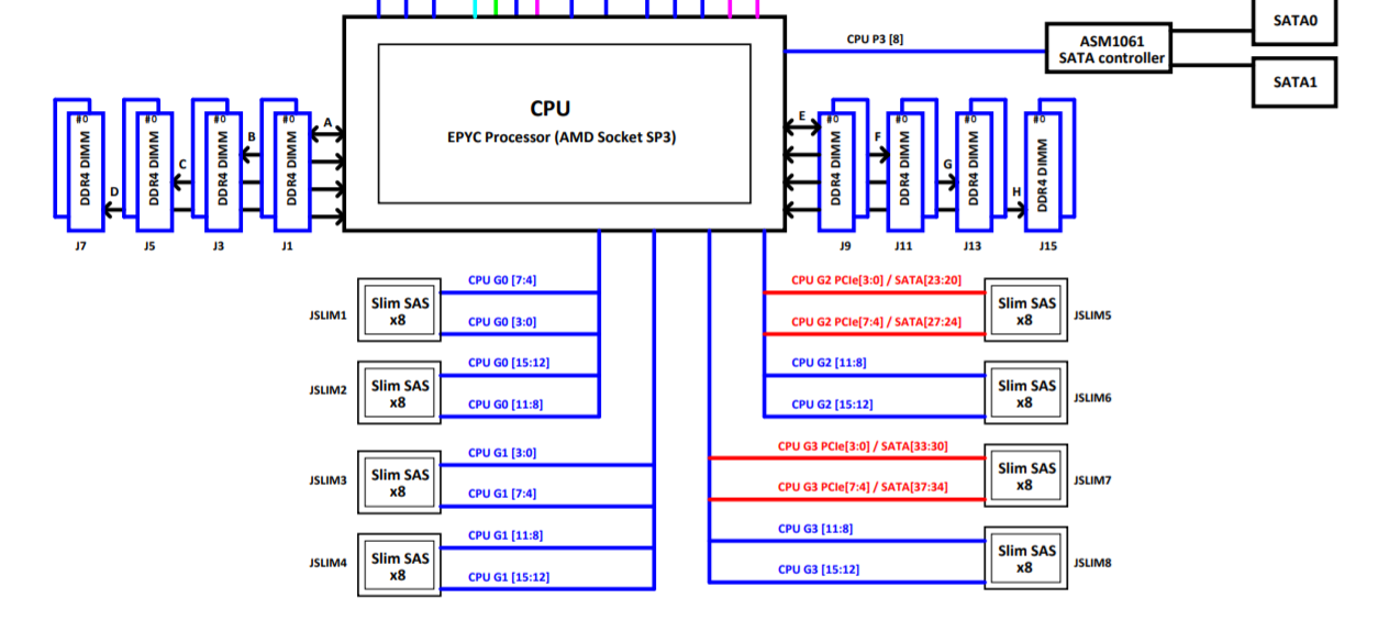

I have been doing some more work/tests.
First i verified that the nvme disks actually was correctly mapped to the pcie lanes.
  HostBridge
    PCIBridge
      PCI 01:00.0 (NVMExp)
        Block(Disk) "nvme8n1"
    PCIBridge
      PCI 02:00.0 (NVMExp)
        Block(Disk) "nvme9c9n1"
    PCIBridge
      PCI 03:00.0 (NVMExp)
        Block(Disk) "nvme10c10n1"
  HostBridge
    PCIBridge
      PCI 41:00.0 (NVMExp)
        Block(Disk) "nvme6c6n1"
    PCIBridge
      PCI 42:00.0 (NVMExp)
        Block(Disk) "nvme7c7n1"
    PCIBridge
      PCI 45:00.0 (Ethernet)
        Net "eno1np0"
      PCI 45:00.1 (Ethernet)
        Net "eno2np1"
    PCIBridge
      PCI 46:00.0 (SATA)
        Block(Disk) "sdb"
        Block(Disk) "sda"
    PCIBridge
      PCIBridge
        PCI 4a:00.0 (VGA)
    PCIBridge
      PCI 4d:00.0 (SATA)
    PCIBridge
      PCI 4e:00.0 (SATA)
  HostBridge
    PCIBridge
      PCI 81:00.0 (NVMExp)
        Block(Disk) "nvme4c4n1"
    PCIBridge
      PCI 82:00.0 (NVMExp)
        Block(Disk) "nvme5c5n1"
    PCIBridge
      PCI 87:00.0 (SATA)
    PCIBridge
      PCI 88:00.0 (SATA)
  HostBridge
    PCIBridge
      PCI c1:00.0 (NVMExp)
        Block(Disk) "nvme0c0n1"
    PCIBridge
      PCI c2:00.0 (NVMExp)
        Block(Disk) "nvme1c1n1"
    PCIBridge
      PCI c3:00.0 (NVMExp)
        Block(Disk) "nvme2c2n1"
    PCIBridge
      PCI c4:00.0 (NVMExp)
        Block(Disk) "nvme3c3n1"

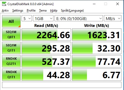

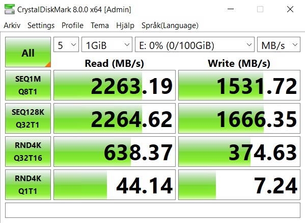

I received my Chelsio T580-LP-CR card so i can now run mpio to the hosts.
So i configured iSCSI with two separate networks and enabled roundrobin with io=1 on the hosts.
I created a VM with OS disk locally on the host, and then added two hardrives to it, one in each zvol, and thats the only IO the zvol is seeing, nothing else is on there.
This gave me the following performance.
PM983
PM1733
Are these values "good" in comparison what kind of disks i have?
I have yet to tune the kernel variables, so there are more job to be done.

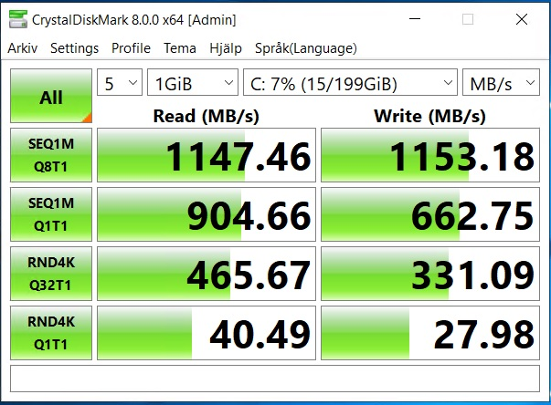

Would you mind taking a look at this, is this to be expected or am i missing something?
Drives 4-7 (inclusive) seem to be sharing a PCIe host port with the SATA and onboard 10GbE. This might be harming their performance in remote-access tests - are you able to try with an add-in NIC?
I noticed you're using 512-byte granularity in your read tests. If you switch to 4K do the same performance results appear? It wouldn't be unreasonable to think that the newer PM1733s aren't tuned for the same "legacy" 512-byte sector performance.
Just out of curiosity, what's the temperature of the PM1733's when you're running those tests? My experience with them is they run rather hot.
I'd check into this. Enterprise NVMe runs downright toasty, to the tune of 20W+ per drive usually, and I recall there being some issues with thermal throttling under extended workload in earlier Samsung drives. Check the firmware as suggested, and also look at the nvmecontrol output to see if perhaps to counter this they were set to a lower power state out of the box.
Couple questions.
1. With the RMS-300 in place, what's the impact on your RND4K write values? Especially the Q1T1 while aligns with the "guest OS demands immediate write with data integrity" performance.
2. CrystalDiskMark isn't an ideal way to test the full/concurrent throughput of multiple machines. Are you comfortable setting up something like HCIBench instead? This will more accurately represent a multi-VM workload.
Herr_Merlin
Oct 25, 2019
200
Use atto to test for a solo VM with random values to see more "true" performance and only cache

How do you come to the conclusion that they share PCIe lanes? Would be interesting to know. They shouldnt do that, here's a screenshot of the arcitecture for the motherboard.
