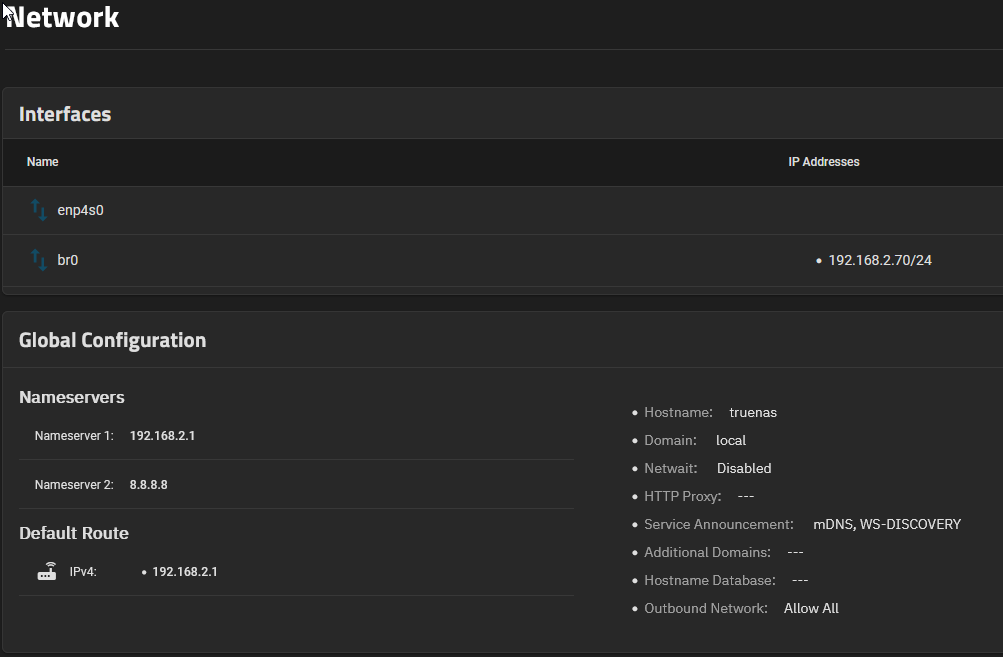

I have the following Setup:
WG_POST_UP:
iptables -t nat -A POSTROUTING -s 10.8.0.0/24 -o br0 -j MASQUERADE; iptables -A INPUT -p udp -m udp --dport 51820 -j ACCEPT; iptables -A FORWARD -i wg0 -j ACCEPT; iptables -A FORWARD -o wg0 -j ACCEPT;
WG_PRE_UP:
iptables -t nat -F; iptables -F;
Host Network is ticked
Network Setup of TrueNAS:
I am able to see the connected device in the Web-Interface.
Black_Duck
Oct 8, 2022
61
Nothing obvious there...
Log into the wg-easy shell and issue the following commands: "iptables -L -v -t nat" and also "iptables _L -v"
Compare your results to the ones I published here in my debugging procedures.
If nothing stands out, then DM me the results.
Also, I note you are running a bridge. When you say you can't access local devices, do you mean physical devices on the lan (eg. your router) or addresses on your Truenas (i.e. a VM or App)... or both?

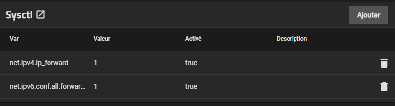

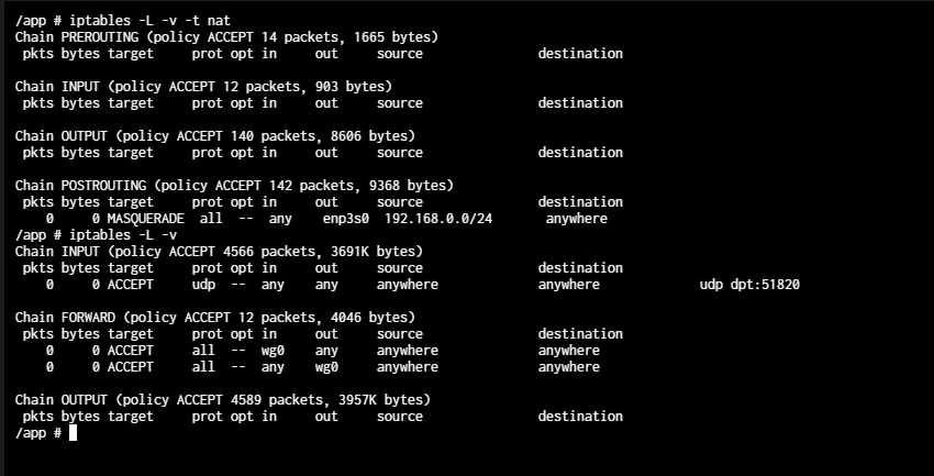

thearmm85
Oct 26, 2023

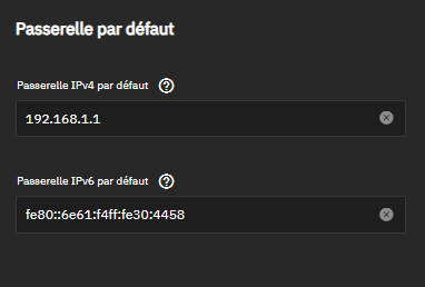

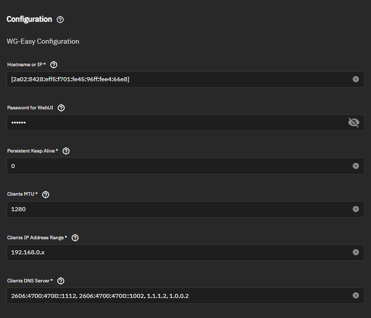

Good morning,
First of all, thank you for your tutorial which helps a lot.
However I have some concerns. I may have a particular configuration. my connection is "IPv6 & IPv4 CGNAT" so I only have public IPv6.
I intentionally set the MTU to 1280 because of my IPV6 configuration.
The problem is, I do not have access to the internet and the web interface of my truescale and wireguard when I am outside my local networks, however I can see that the connection works on the wireguard interface. No problems on my local networks.
my configuration:
Thank you in advance for your assistance :)
Black_Duck
Oct 8, 2022
61
Hi thearmm85
A couple of observations:
To clarify, your isp provides you with an IPV6 address and a CGNAT IPV4 address.
Do not use IPv4 with CGNAT as It will mess up your port forwarding.
I assume you are using a static IPv6 address and you are using NAT64 on your router(?) and using IPv4 on your local network.
If you are attempting to use IPv6 addressing as well on your lan, then things get really complicated. The default route tables will not work for IPv6 addresses. I suspect you will need to add a postroute (masquerade) with source being your IPv6 subnet. You will also need to have an IPV6 address range for the WireGuard subnet…
This is fine and correct.
Are you sure the connection works? Your iptables printout shows zero traffic through WireGuard?
Remember Wirequard runs silent - you could be seeing packets sent, but unless you see packets being received, you are not connected.
When you say you can’t access your “truescale” do you mean your nas? Are you using its ipv4 address?
i can understand you may have problems accessing the web. Be aware that under your config, all of the VPN is running in IPv4. I don’t know enough about NAT64 conversion to help here.
my configuration:
From your Network Interface screen shot, you appear to be using subnet 192.168.1.x on your lan as well as IPv6 subnet…
You have specified subnet 192.168.0.x to be used in your WireGuard clients. Any reason you changed from the default of 10.8.0.0/24?

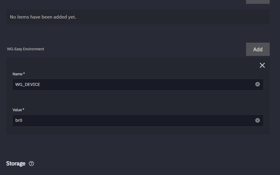

  • Name: WG_POST_UP
  • Value: iptables -t nat -A POSTROUTING -s 10.8.0.0/24 -o br0 -j MASQUERADE; iptables -A INPUT -p udp -m udp --dport 51820 -j ACCEPT; iptables -A FORWARD -i wg0 -j ACCEPT; iptables -A FORWARD -o wg0 -j ACCEPT;
Thanks for a head up about port 51820. For the NIC, you can just use built-in option WG_DEVICE = NIC_NAME without iptables setup.
Black_Duck
Oct 8, 2022
61
Sadly this does not work for the iX Catalog version of wg-easy. The iX Catalog version pulls the docker image weejewel/wg-easy. Unfortunately, this docker image does not support the WG_DEVICE option. See post https://www.truenas.com/community/t...ssumes-interface-name-eth0.107407/post-770854 for more details.
I did raise a ticket on this issue (NAS-125186), but no response yet.
It now does. Use Device name.

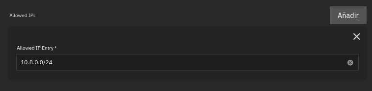

I followed this guide on a SCALE installation and worked very well, but I'm facing one issue. I don't want that clients use wireguard to forward all traffic, so I set up Allowed IP's with 10.8.0.0/24 and another specific IP. The problem is when I generate the config files in wg-easy it always use the default one (0.0.0.0/0,::/0). Any ideas on what can be happening and how to solve it? is this a bug?
Black_Duck
Oct 8, 2022
61
The 10.8.0.x IP Address Range in the wg-easy app configuration is the Address range to be used by Wireguard Clients. To set the Allowed IPs you need to add through the app configuration ("Allowed IPs") or by setting an Environment Variable (Name=WG_ALLOWED_IPS, Value={the IP addresses you allow}). Example value is "192.168.15.0/24, 10.0.1.0/24". Both ways work using version 7_1.0.12 - that is the generated config file has the changed "Allowed IP".

krasny
Dec 6, 2023
Note that this merely places the value in the wiregruard client config file which can be easily be changed from within the wireguard client or by editing the config file. If you want to limit allowed IPs in such a way that they cannot be bypassed, you will need to updated the wireguard iptables to only forward allowed ip addresses.
Thank you for your reply!
Yes, I know that you can edit manually to change the IP's, but since I want that people with no much knowledge about this use the wg-easy interface I would prefer if the configuration file is ready to use.

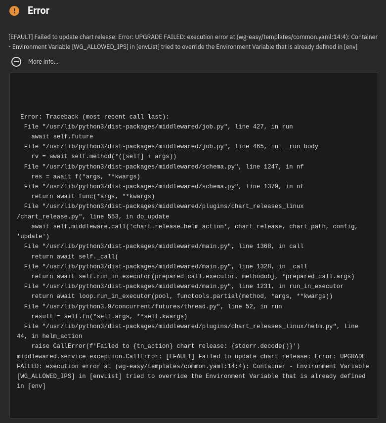

The weird thing is that I did exactly what you described, Introducing the range in Allowed IP's field but the config appears with the default one:
Also I did try with the WG_ALLOWED_IPS in environment but I get an error because it seems that the configuration is duplicated, even after I removed the Allowed IPs field:
Is there any way to configure manually this values inside the container? I'm using 7_2.0.1 version from official charts.
thank you very much!
