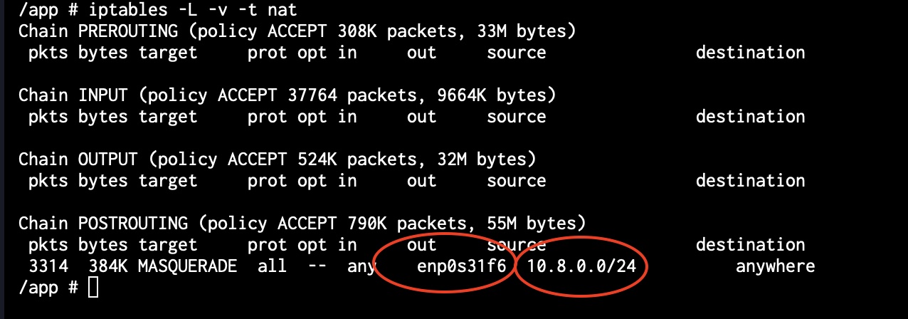

        1. Yes: problem is most likely you have the wrong Network Interface specified in the route tables
          • Go into the wg-easy shell and issue the following commands: "iptables -L -v -t nat".
          • Output should be something like:
          • Note that the "out" should be your Network Interface (see 3 in guide above). Also check "source".

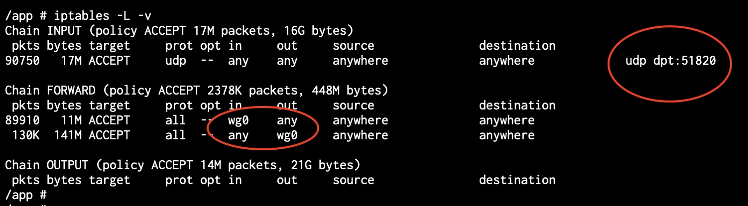

          • Go into the wg-easy shell and issue the following command "iptables -L -v"
            • Check you have correct UDP port in the INPUT rule
            • Check you have a FORWARD from any to wg0 and from wg0 to any

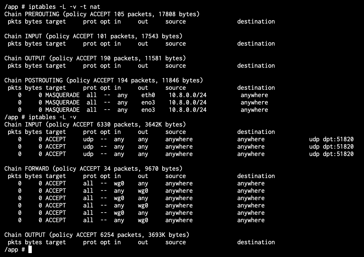

actually none of this was here in chain packets 3314 384K
its just 0
its just 0
This tells you the number of packets going thought the rule. It means that no traffic is going through your Network Interface, which is consistent to no access to the internet.
Can you share your iptables output?
