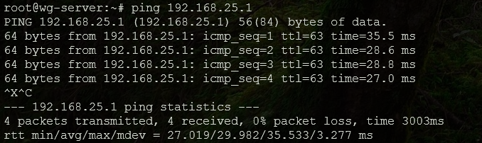

At this point you should be able to ping applications on your truenas from your VPS.

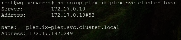

3 - VPS - DNS resolving:
/etc/resolv.conf
nameserver 172.17.0.10
search svc.cluster.local cluster.local
Note: you might need to install resolvconf on your VPS in order to be able to edit resolv.conf..
When this is done, you should now be able to ping plex.ix-plex.svc.cluster.local from your VPS..
You can use this in your reverse proxy as well, if you have a domain. Make sure to use corects ports as well.
