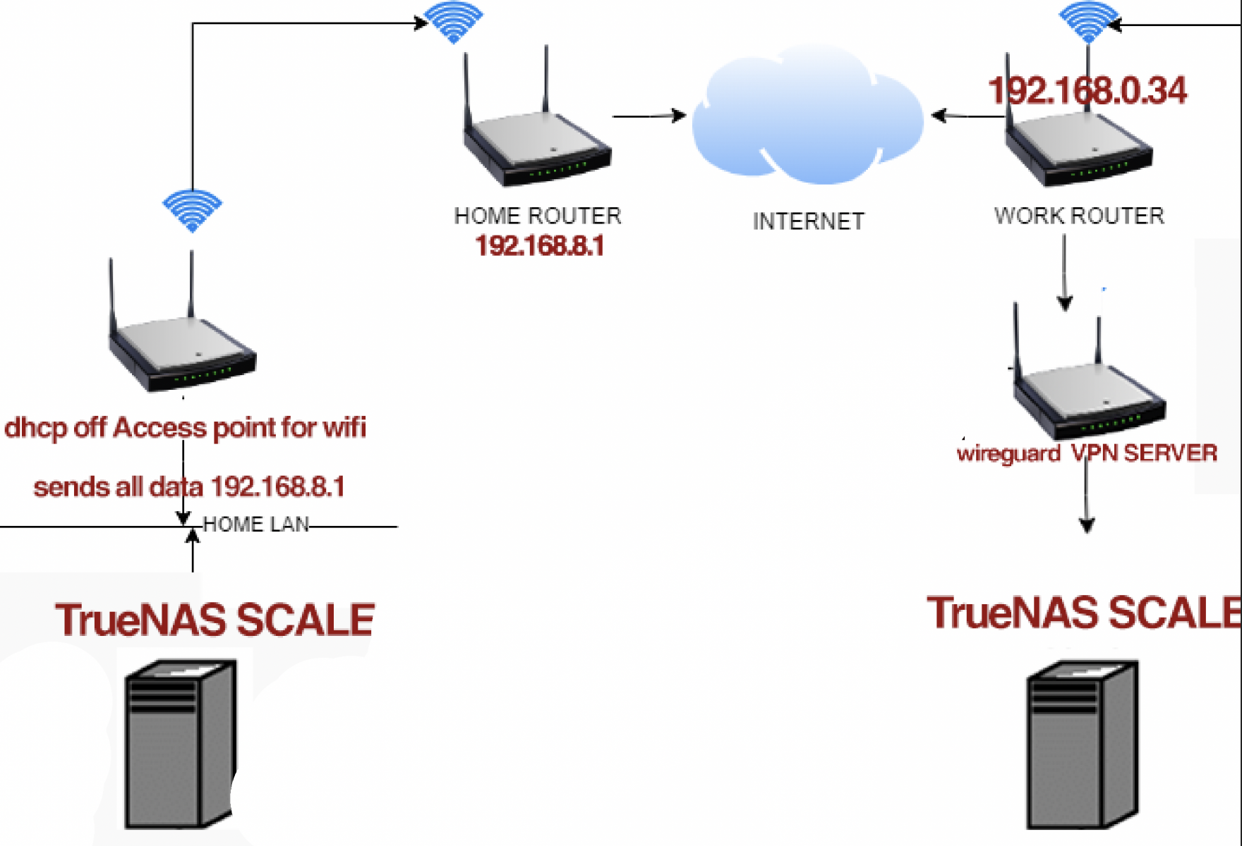

I can’t ping my offsite server using servers but I can inside the WG app's CLI
Only the WG app shell can ping devices on the WG network. OS CANNOT
Here is both ends of the client im trying to connect via the server Server address as named in the working connection
SERVER WG ADRESS 10.0.0.1/24
HOME ROUTER 192.168.8.1
Home NAS 192.168.8.144

OFFSITE ROUTER FIRST AT INTERNET 192.168.0.1
ROUTER 2
192.168.0.34.
NAS ADRESS 192.168.0.206

THE SERVER IS A ROUTER, but on the other side there is a ISP ROUTER and on that there is a VPN router (my wireguard server)
And my traffic from home is tunneling out of my network and into offsite ISP router Via 48574 UDP port and then its forwarding to the VPN router successfully and vice versa.
Out of lan I can connect to both sides and they BOTH are part of wireguards network and
ARE ACTIVE MEMBERS OF THE WIREGUARD NETWORK CURRENTLY
But I cant send data :’( as Only wireguards App Within Truenas can ping the connected network
I even got tailscale working but it’s to slow and I copied the Routes from that and it didn’t work so here my config, hopefuly someone can point out something that im missing I would be very grateful
