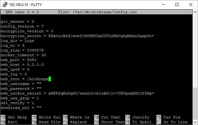

you should add /sickrage to the webui
Feb 3, 2016
13
I've already done this. I checked just to be sure but still, there doesn't seem to be anything wrong. Unless you mean something different.
Joshua Parker Ruehlig
Dec 5, 2011
5,949
Feb 3, 2016
13
I mean to URL you are browsing to. the link from the freenas webui will no longer work.
That worked. Thank you. Is there any way to get it to redirect to that url all the time?
