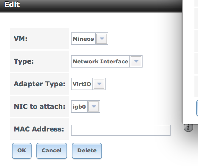

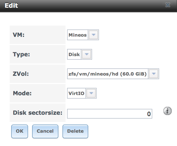

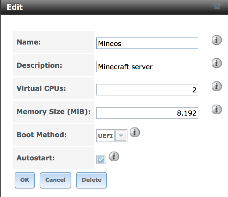

The machine has got the two devices, who's config I attached. I don't need VGA/VNC for machines running FreeBSD or Linux. The guest OS is RELENG_10_4, but machines with RELENG_11_1 or Ubuntu behave exactly the same way.
Patrick
