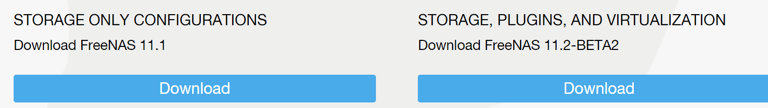

I'm confused by the download page. I want more then just storage out of my new NAS. Should I be going with this beta version for my initial install? Is it stable because I plan to start adding important data right away? I guess I don't understand the upgrade cycle. Can someone please advise? Thanks!

I may not be asking the right question here. Any caveats of going with a beta for my first build?

Do you want to trust your important data to beta test software? The risk should be low, but you may be bitten.
For safety, install the current stable release, 11.1 (11.1-U5), found on the left side of the download page.
You are not the only one. It is saying that 11.1 is not good for anything but storage.
Short answer? No!

Like the others have said, start with 11.1-U5.
FreeNAS 11,2 only recently entered it's beta2 stage. They are planning beta3 and rc versions. The release version of 11.2 is scheduled for 3 months from now. Given their previous track records, my guess is that date will be pushed out further.
