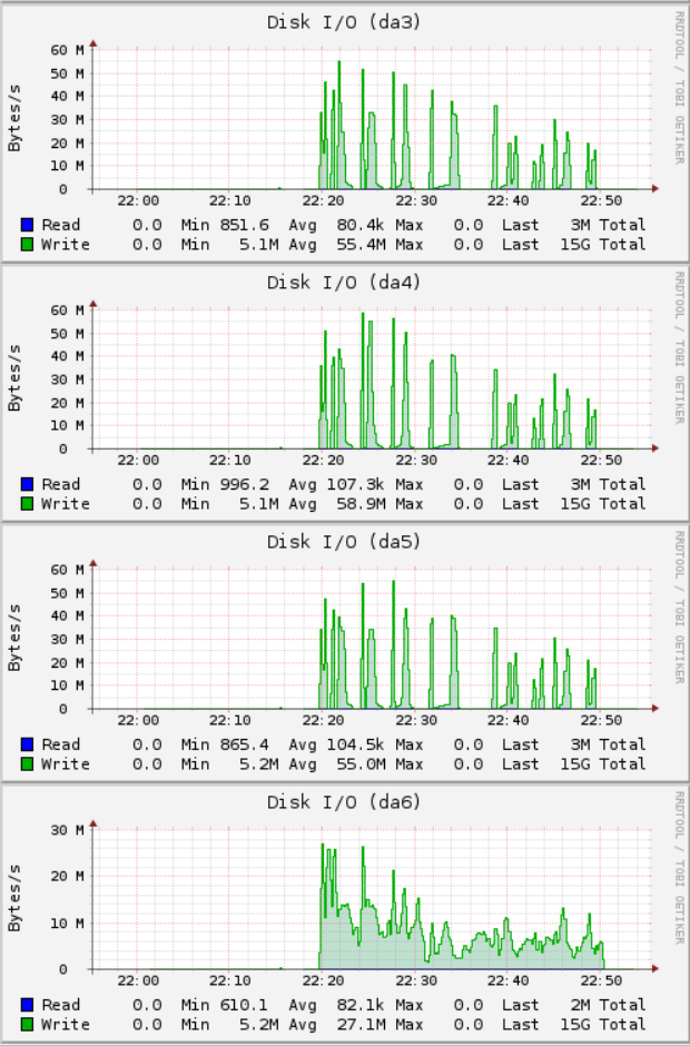

I pulled four 4-year-old drives from my old NAS and plugged them into my shiny new FreeNAS box. They are Seagate 1.5TB LP (Low Power) drives, ST31500541AS. I put them in a four-drive RAIDZ2 to test performance. I used dd to test them (with compression turned off on the dataset):
dd if=/dev/zero of=/mnt/fourseagates/testfiledeleteme.dat bs=2048k count=25k
23314038784 bytes transferred in 1733.059391 secs (13452533 bytes/sec)
...and the performance is atrocious, 13 MB/s. So I looked at the drive usage report plots:
...hmm, da6 seems to be working harder and is nonsymmetric compared to the other drives, which appear identical. You'll also notice that da6 isn't even on the same y-scale as the other plots, it is on a smaller y-scale.
I checked the SMART data and found that no tests had ever been run on these drives. Blame my former ignorance. But nothing seemed to be wrong with them as far as I could tell, no reallocated sectors or anything. I am running a SMART long test on them and we'll see what that tells me.
But in the meantime, a question for posterity: Should drive usage always appear symmetric on a very healthy array? If you were just browsing and noticed the above reports on your NAS, would you be alarmed?

First, that chart was NEVER EVER meant to be compared in the way you are comparing. gstat is far more accurate because it provides better resolution. SMART data and SMART testing would be the first thing I'd look at.
zpool iostat 1 will give you 1 second breakdowns for pool usage.

One trend that I thought was seeing when I was troubleshooting using the RRD graphs to diagnose this is that the SATA4 and SATA7 drive bays were the only ones that acted up. But it seems like maybe only certain drive/bay combinations have the issue, which makes no sense to me. I am just making myself more confused.
I will look into these commands you have mentioned.
Any other good diagnostics that I could try? I am really at a loss at this point.

cyberjock
Inactive Account
Mar 25, 2012
19,525
Not a clue since you are just posting random command output and providing ZERO information on what you are doing. You're basically saying "see.. look at my broken shit" with no context at all.
And like I said before... SMART is what I'd look at first, yet you provided nothing on that...
HoneyBadger
actually does care
Administrator
Feb 6, 2014
5,112
As cyberjock suggests, do a smartctl -a (device) and post the results of each, in separate code blocks or on Pastebin.
I'm not sure what the idle-sleep timer is on the Seagate Greens but generally speaking "low power" equals "low performance"
scurrier
Jan 2, 2014
297
Sorry I looked at SMART myself but did not see much besides a few command_timeout errors and some UDMA_CRC_Error_Count errors. They are very low numbers which aren't alarming to me considering that these drives have been running for 4 years. I would appreciate others' takes on this data though. Here's the SMART output for the disks.

Not a clue, but almost every disk has a non-zero value for "command timeout". That's a bad thing, and indicative of some kind of problem. Now if that problem is hardware or software(aka driver or misconfigured BIOS setting) is anyone's guess. They are relatively old though, all being over 25k hours. Other than the command timeouts they appear to be in good shape. I've never seen a non-zero for command timeout from anyone here before(and I've seen alot of disks).
And despite you fears of lower performance, those 4 drives should be able to saturate Gb LAN. So unless you plan to run 10Gb LAN, those drives aren't going to be your bottleneck.. your NIC is.
To be honest, my first guess is user-error of some sort. By user error I mean something isn't configured properly somewhere. Either the BIOS, your RAID/IT controller, or FreeNAS. I'm not sure which because there's so many ways you could have something wrong I don't even know where to start narrowing down the problem. It could even be some setting I'd never consider to be out of place. It happens.
Don't take this personally, but its far easier to get stuff wrong than to get stuff right. And at least once a week someone shows up here that set some setting to something so incredibly stupid I couldn't have guessed it given 100 guesses and offered 1 million dollars.
What I'd do next is:
1. Destroy your pool(if you can).
2. Open 4 ssh windows and do dd if=/dev/XXXX of=/dev/null bs=1m for all 4 disks at the same time. See what gstat shows for the disks(A screenshot or paste here would be nice). This will simply prove that the 4 disks can provide good speed individually(and they'd better since this test is their bread and butter for setting benchmarks).

Here are some gstat screenshots done while using the dd command on all disks, as you suggested.
index.php
index.php
index.php
That third screenshot shows something that I noticed happening every 10 seconds or so when I first started the test. Disk ada2 would hiccup like you can see in the screenshot. I happened to catch the worst one I ever saw in this third screenshot. Most of them were more like dips to 65000 or 75000 kBps.
Now that I'm about 40 minutes in, the disks seems to ride along pretty evenly, independently slowing or speeding up +/- 10000 kBps or so.
But I did see something strange about 30 minutes ago. I didn't catch it in a screenshot, but I'll reproduce it here.
dT: 1.001s  w: 1.000s  filter: ada?.$
L(q)  ops/s    r/s  kBps  ms/r    w/s  kBps  ms/w  %busy Name
    1    651    651  83373    1.5      0      0    0.0  99.7| ada0
    1    781    781  99996    1.3      0      0    0.0  99.5| ada1
    1    746    746  95520    1.3      0      0    0.0  99.6| ada3
Again, ada2 seems to be behaving differently than the others. Seems pretty damning for ada2 (serial 9XW028EV). I looked back at the SMART data and that is the only disk that had a non-zero UDMA_CRC_Error_Count. When I posted the SMART data it had a value of 2 and it still has a value of 2. Same for the Command_Timeout parameter.
The only thing I can think to do now is to let FreeNAS grind on these disks for a while and see if it will force a failure or significant change in the SMART data. I could also try moving them around to different bays and see if their behavior changes. I'm not married to these disks since they are 4 years old but I would like to still use them if it's feasible. Maybe I could relegate them to a less critical application.
Is there any way to do a longer test that will somehow let me plot a time history?

UDMA errors normally don't cause problems like you are seeing. A disk with that many hours on it is going to have a few UDMA errors. That's pretty much par for the course.
If you can, I'd try creating a 3 disk RAIDZ1 without ada2 and see how performance changes. My guess is it'll perform fine and you'll have basically validated that ada2(or something unique to ada2) is the problem.
