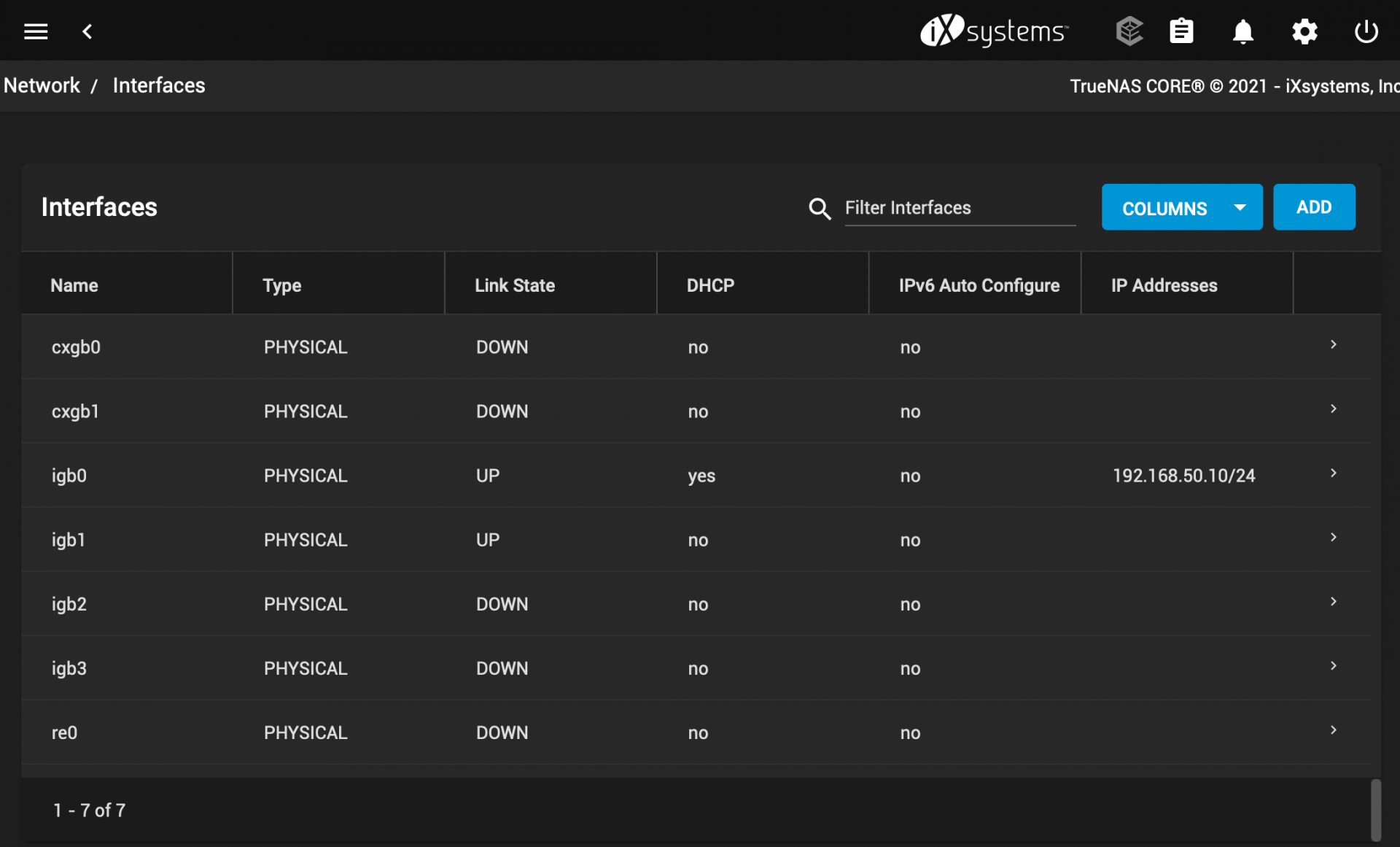

Hmm what would I do? I have an intel 4x 1gb card. When I plug an rj45 into them the lights turn on green and the status in TrueNAS goes from "DOWN" to "UP". I thought the up and down was an indicator of a connection rather than a configuration option....

Try setting an IP address and mask on the Chelsio cxgb0 interface.

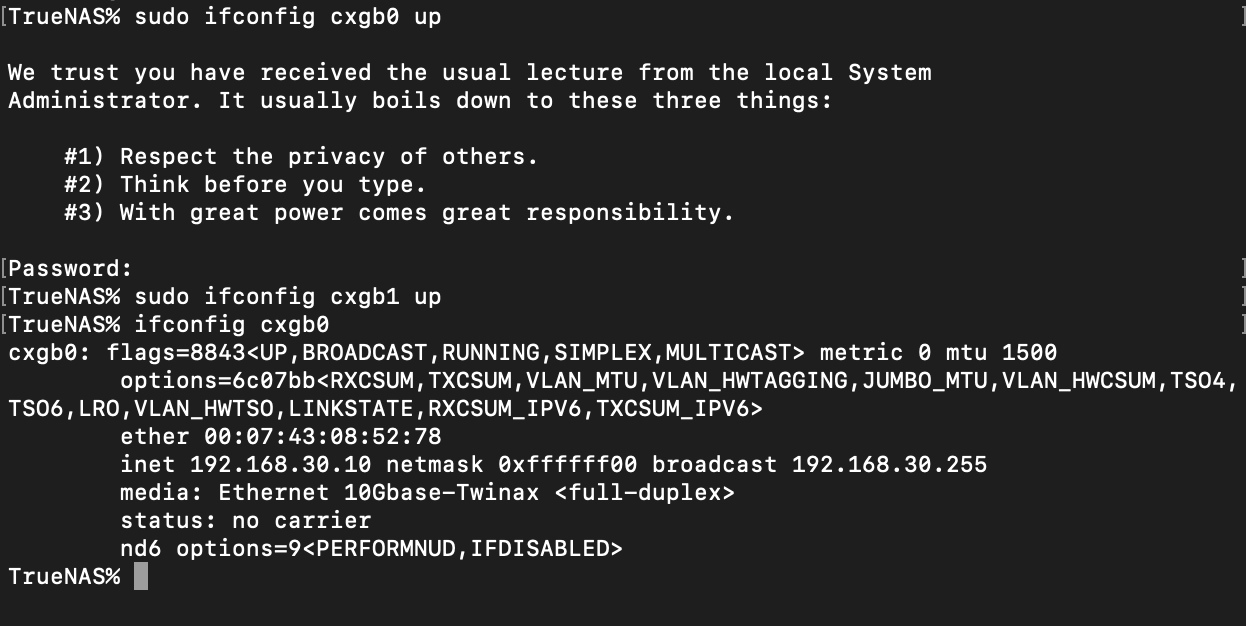

Connect one port of the Chelsio to the other with the DAC cable.
At a prompt, type
ifconfig cxgb0 up
ifconfig cxgb1 up
ifconfig cxgb0
And see what the reported media status is.
The reason I specifically discourage the use of DAC cables in the 10 Gig Networking Primer is because it is a minefield of vendor-coded compatibility issues, and they are rookie-hostile in various other ways. Not to mention that they're fixed length.

No change in link status via the interface. Not sure what all the stuff the terminal spit out means.

Yes, you've confirmed these DAC cables don't work with your Chelsio.

It's vaguely interesting that it detects it as twinax but can't link, but drivers can be weird about these things.
