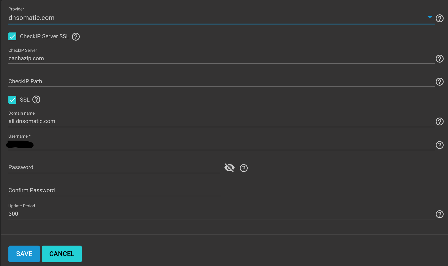

I have tried to set up the service to update DNSomatic but keep having troubles. I fill out the page as follows:
Provider: dnsomatic.com
CheckIPServer SSL: Checked
CheckIP Server: www.checkip.org:443
CheckIP Path: /
Domain name: all.dnsomatic.com
Username: myUserName
Password: myPassword
Update Period: 300

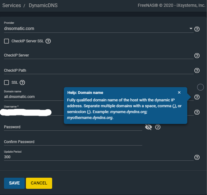

This seems to have been fixed in 11.3, but it took me some head-scratching to get the parameters just right. The Doman Name help text is a bit misleading when it comes to DNS-O-Matic. Not everything that it touches are hosts. Some might be services e.g. Cloudflare or OpenDNS. So that all services get updated, make sure the outgoing request goes to all.dnsomatic.com.

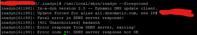

When I try to run inadyn manually from the CLI with `--foreground`, I get a `Bad Auth` response.
I've been editing /etc/local/rc.d/inadyn.conf, but nothing seems to work. I've confirmed my username and password repeatedly but I'm still getting the error. I've tried using both my email address and the username I set when I created the account, and I've tried both all.dnsomatic.com and my actual domain (domain.tld, not host.domain.tld).

I'm still getting a "401 Unauthorized badauth" error, trying with both my actual username and my email address. I guess I'm down to emailing dnsomatic to see if they can help. This is quite annoying.
sammysam4983
Dec 30, 2017
17
Turns out, it was my password! I had a special character in my password that's used in HTML encoding. I replaced it with something else and it worked like a charm!
