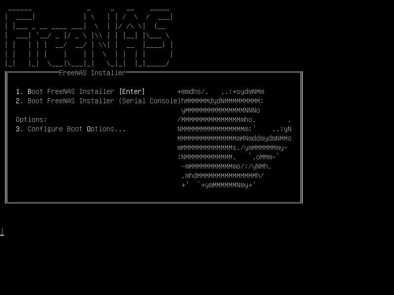

In case anyone is still looking for an answer to this:
At the FreeNAS installer boot prompt, select 3 or O to choose boot options,

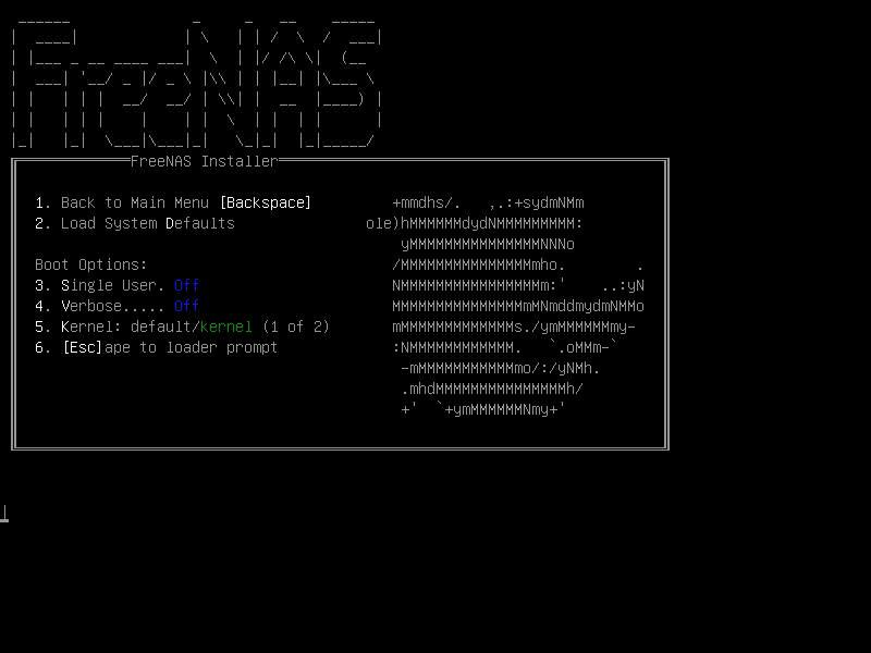

Then at the Options screen, select 6 or Esc to get to the loader prompt

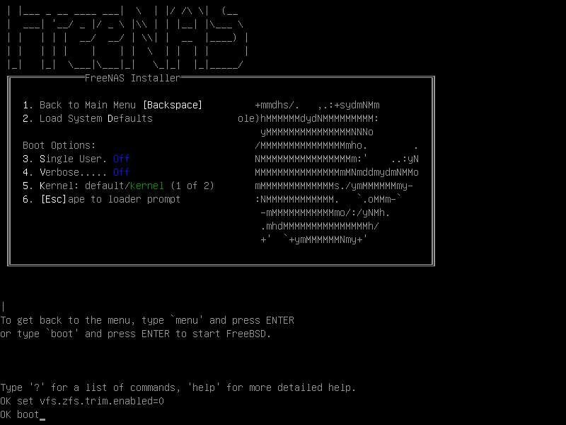

Then type "set <tunable>=<value>" (in the case of erroring SSDs, set vfs.zfs.trim.enabled=0), then type "boot" to boot.
You'll need to repeat those steps at 1) first boot and 2) after restoring config db, if that's what you'll be doing.

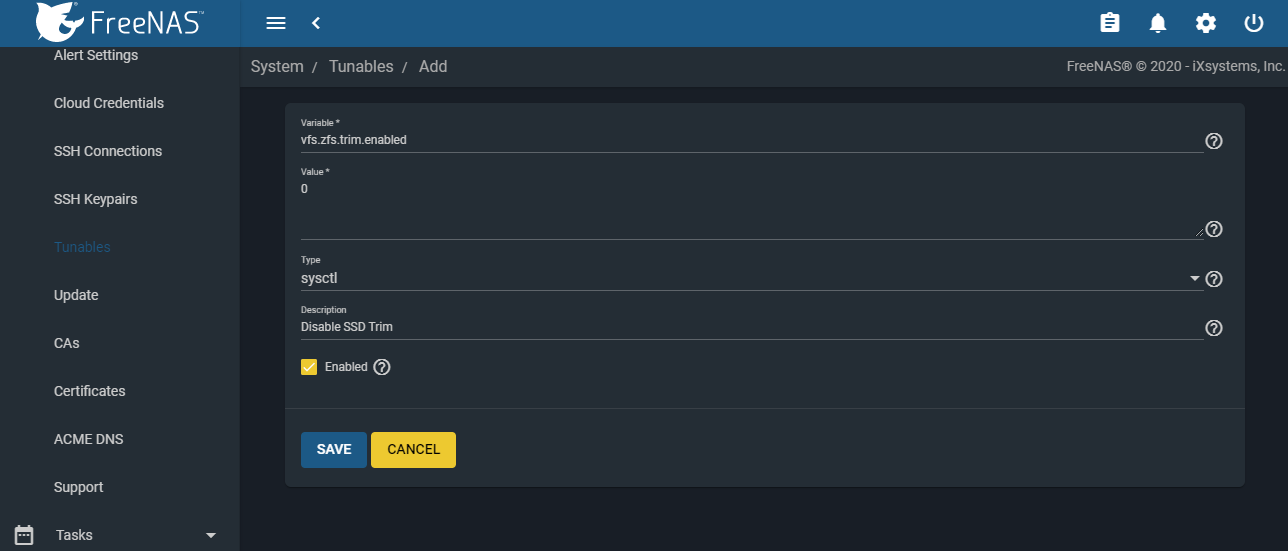

The correct mechanism for setting this is via System->Tunables. You can create a sysctl tunable with those settings, and that will persist between reboots.

These settings are WRONG! See my answer below.
I think that how I set this should be correct:

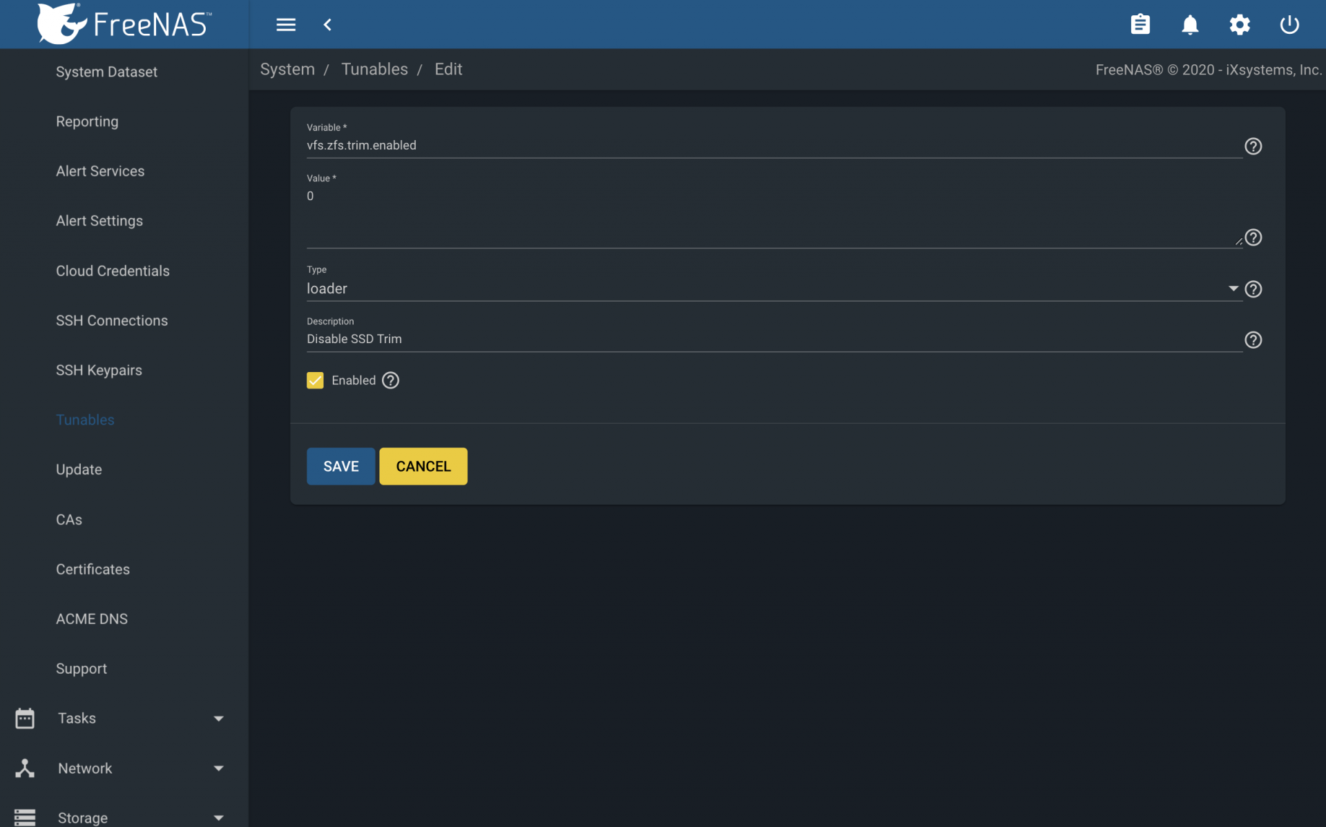

Quick update, the screen I posted on the answer above is wrong.
The boot drive issue happened again, then I found that inside the FreeNAS shell you can use sysctl vfs.zfs.trim.enabled to check if on your running NAS the trim option is enabled or not, and for me, it printed vfs.zfs.trim.enabled: 1, which is wrong.
The correct, working settings for the Tunable are the following:
As you can see, the "Type" wasn't sysctl, but loader.
After doing this, I rebooted the NAS, went into the Shell, typed sysctl vfs.zfs.trim.enabled and the response was finally vfs.zfs.trim.enabled: 0
Hope this helps!
