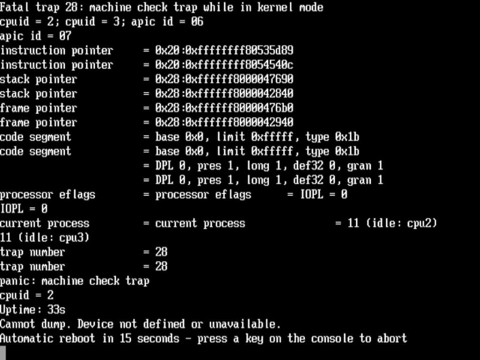

Hi all i just joined the forum today
well i have 4 dell 1850 poweredge server 2 are web servers 2 are file servers
i just install FreeNAS-8.0.1-RC2-amd64 witch i think its 64 bit ?
it installed fine when it was time to reboot it just hangs
here is a snap of the screen and its a bugger to needs to have a hard reset witch is a 30min drive
Thanks

What drivers are you using? Please be sure to post your dmesg output after install in some screenshots so we can see if it's a known issue that's been resolved in a driver in later versions of FreeBSD.

Hmm.. I wonder if the amr driver is causing problems on 64-bit. Could you install 32-bit and see whether or not the panic occurs?
Also, if you can do scroll lock and scroll up to the exact panic message, that would be awesome because in your original screenshot it kind of scrolled off the screen.

time,s up had to get the server back on line last night so i had to remove it but i did try 32 bit same thing
try with next release
