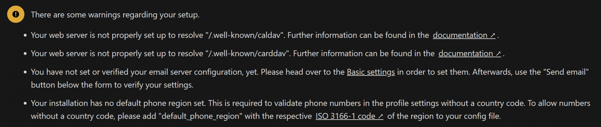

Hello, What command is used to input "'default_phone_region' => 'US'," into my nexcloud shell? I'm newer at commands so trying to find the full sequence of commands to make this happen.
You've replied to a year-old thread on a very different question, so I doubt you're going to get much help here--you'd be better off starting a new thread. When you do, you can include quite a bit more information about your installation--like which version of TrueNAS you're running and how you installed Nextcloud, for starters.
