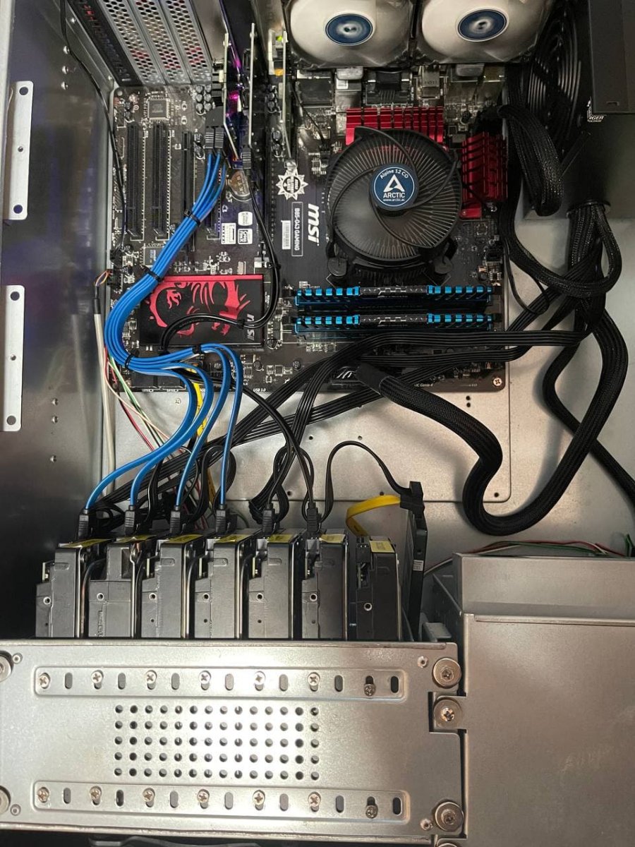

andreaconfa
Jun 30, 2019
14
I’m a home user, not a business so my only choise is a consumer motherboard.
I restore the standalone installation with working 8gb of ram now (tested 24h with memtest) keeping the two sata controller card
Then if someone can help me to find the problem I would appreciate it very much.
I replaced all the sata cable with new one arrived today from amazon
What more information I need to provide to help understand the problem?
