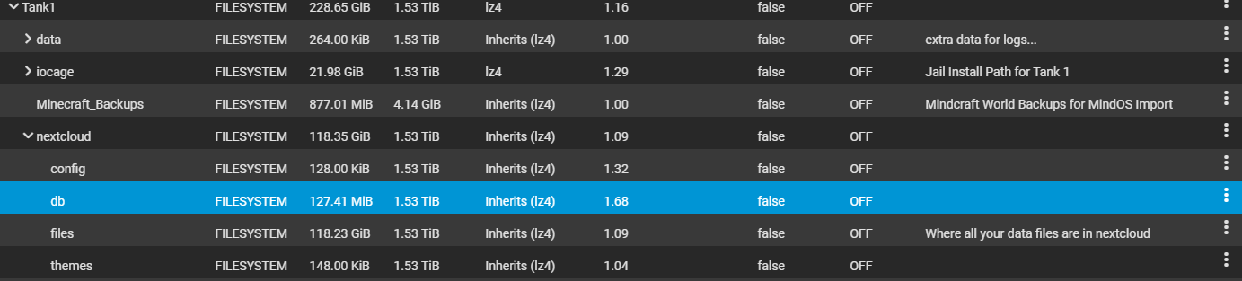

Thank you for the replay @danb35 You are a god in my book so I will try and response to you the best I know.
the files are still there as you said.
here is the old config
JAIL_IP="10.0.0.39"
DEFAULT_GW_IP="10.0.0.1"
POOL_PATH="/mnt/Tank1"
TIME_ZONE="America/New_York"
HOST_NAME="vitXXXXX.com"
STANDALONE_CERT=1
CERT_EMAIL=joseph.XXXX@outlXXX.com
DNS_PLUGIN="cloudflare"
DNS_ENV="joseph.XXXX@outlXXX.com=foo@bar.baz CLOUDFLARE_API_KEY=blah"
Do I have to change anything here? do we go through the same process with the SSL certs? I'm thinking we keep them given we still want it to auto update
Also your scripts seems to install NC.19 will this be an issue I was at nc.20.4
I also had other configs within nextcloud I guess I can't get them back given the jail is gone? I do have an old snapshot can I extract that and see If I can find them?
I will wait for your replay.
Thank you,
Joe

15,504
Yes, you'll need to get an API Token from Cloudflare. The README describes the process.
No, actually you won't, because you're getting a standalone cert. You can safely delete the DNS_PLUGIN and DNS_ENV lines.
True, I haven't updated to 20 yet. You should be able to install 20 by editing line 298 of the script to read:
FILE="latest-20.tar.bz2"
I'll caution, though, that as yet I haven't had time to mess with NC 20.
Dellyjoe
Jun 12, 2020
80
Will it renew automaticity even if I don't include the two lines below? also should I re download the script given we are in Truecore ? and not freenas?
And I will just leave it with nc. 19 given I can just update it when I have it up and running.
Just want to be sure, given I don't want to mess anything up again.
Joe
15,504
Yes--again, you're telling it to get the standalone cert (i.e., to use HTTP validation), so the DNS parameters are irrelevant.
TrueNAS vs. FreeNAS shouldn't make a difference, but I'd recommend updating the script. git pull.
Dellyjoe
Jun 12, 2020
80
ok, thank you danb35 I will let you know how it goes !
Joe
15,504
To be on the safe side, take a recursive snapshot of the nextcloud dataset first. That way, if it borks your data, you can roll back.
