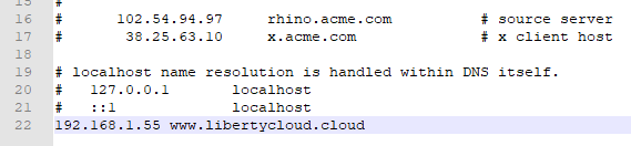

Not all routers are capable of acting as a DNS resolver. Easiest at this stage to test using the local hosts file. Google is your friend here e.g. Hosts File in Windows 10 : Locate, Edit and Manage (assuming you're on a Win 10 PC). Once you test and are able to confirm that it indeed solves the issue, lock for the equivalent functionality on your router or other local DNS resolver you might be using (pfSense, DNSMasq, etc).
liberty87
Mar 24, 2020
21
I did this but it doesn't work the same .... if I put ip jail on the browser I don't access nextcloud.

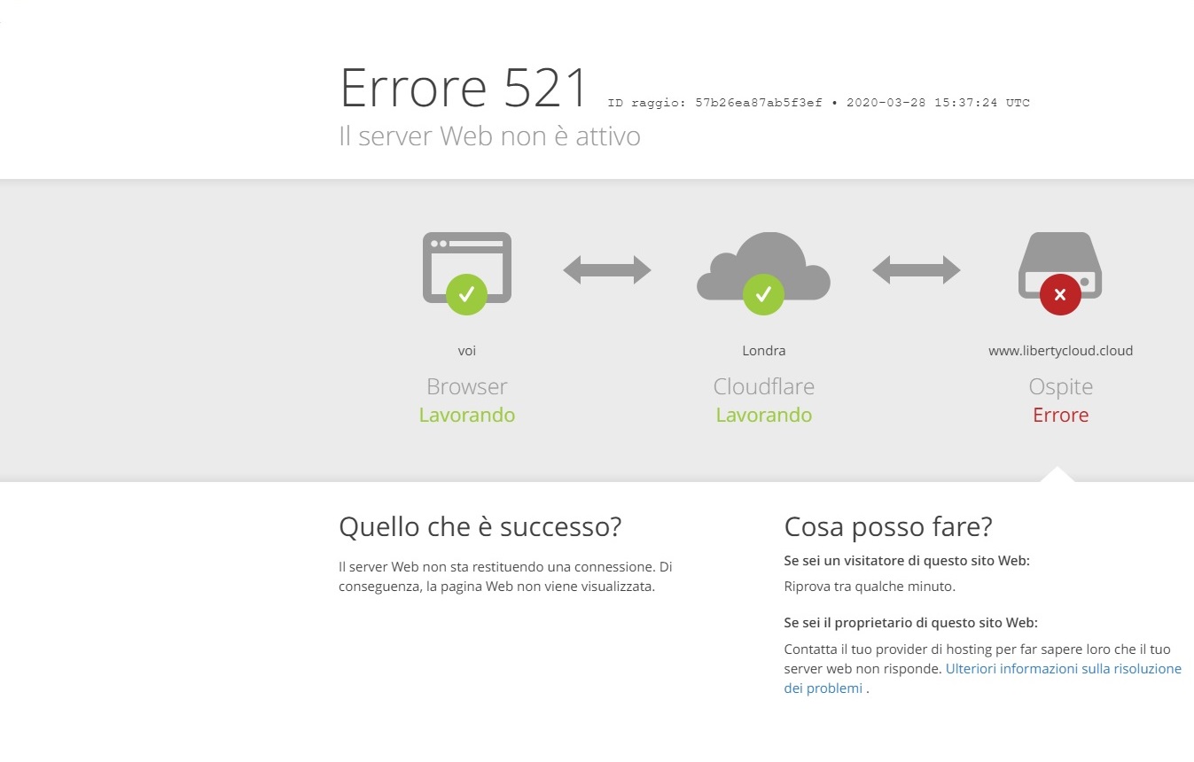

because when I turn off and on the nas again I can no longer access nextcloud from my domain?
Can anyone help me? I currently own a purchased domain, I made an account on cladflare, I linked my domain, in the control panel of my domain I entered the claudflare dns, not having a static ip I registered on dns-o-matic and set the claudflare data. in my router I set the dns of dns-o-matic. But after a few days, turning on my nas I can no longer access nextcloud. appeva I enter my domain I see the page in the picture. What am I doing wrong?

Can anyone help me? I currently own a purchased domain, I made an account on cladflare, I linked my domain, in the control panel of my domain I entered the claudflare dns, not having a static IP I registered on dns-o-matic and set the claudflare data. in my router I set the dns of dns-o-matic. But after a few days, turning on my nas I can no longer access nextcloud. appeva I enter my domain I see the page in the picture. What am I doing wrong?
On your private network, in a browser, when you enter http://192.168.1.55, which I presume is your Nextcloud jail IP, what do you see? What about when you enter https://libertycloud.cloud?
