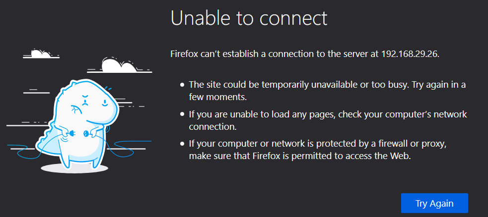

Accessing the jail IP via browser takes about 3 seconds then goes to "Unable to connect" firefox error (attached).

10. Once done, go to jail IP, observe this time attached webpage lol
