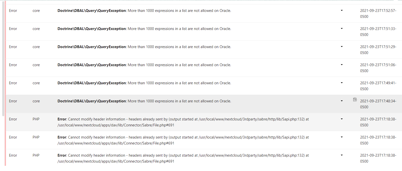

I have been getting some errors from nextcloud log and the problem might be some PHP stuff. So, I went ahead and do a
pkg update && pkg upgrade
. Then I get the error as shown below. How do I upgrade mysql? and Do I also need to remove www.conf?

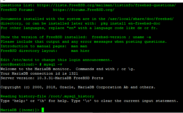

I'm getting a message saying:
This installation of MySQL is already upgraded to 10.3.31-MariaDB, use --force if you still need to run mysql_upgrade
I check the MySQL version and it's still saying it's 10.3.30. Any idea what's am I missing here?

Within the nextcloud jail. I did mysql -v and here is the result I get.
pkg info got me this

T_T
Member
Jul 24, 2018
56
I am also getting the same error whenever I try to do the auto upload photo thing on the IOS app. I don't know if the 2 problems below are related to the auto uploading issue. But it seem like every time I try to turn on on the auto upload. It only upload around like 200 files out of ~34k files. My nextcloud jail would freeze and I can't even do iocage --force stop nextcloud.
Within Doctrine\DBAL\Query\QueryException: More than 1000 expressions in a list are not allowed on Oracle.
[core] Error: Doctrine\DBAL\Query\QueryException: More than 1000 expressions in a list are not allowed on Oracle. at <<closure>>
 0. /usr/local/www/nextcloud/lib/private/Comments/Manager.php line 656
    OC\DB\QueryBuilder\QueryBuilder->execute()
 1. /usr/local/www/nextcloud/apps/dav/lib/Connector/Sabre/CommentPropertiesPlugin.php line 89
    OC\Comments\Manager->getNumberOfUnreadCommentsForObjects("files", ["259650","26000 ... "], OC\User\User {})
 2. /usr/local/www/nextcloud/apps/dav/lib/Connector/Sabre/CommentPropertiesPlugin.php line 117
    OCA\DAV\Connector\Sabre\CommentPropertiesPlugin->cacheDirectory(OCA\DAV\Connector\Sabre\Directory {})
 3. /usr/local/www/nextcloud/3rdparty/sabre/event/lib/WildcardEmitterTrait.php line 89
    OCA\DAV\Connector\Sabre\CommentPropertiesPlugin->handleGetProperties(Sabre\DAV\PropFind {}, OCA\DAV\Connector\Sabre\Directory {})
 4. /usr/local/www/nextcloud/3rdparty/sabre/dav/lib/DAV/Server.php line 1052
    Sabre\DAV\Server->emit("propFind", [Sabre\DAV\PropF ... }])
 5. /usr/local/www/nextcloud/3rdparty/sabre/dav/lib/DAV/Server.php line 984
    Sabre\DAV\Server->getPropertiesByNode(Sabre\DAV\PropFind {}, OCA\DAV\Connector\Sabre\Directory {})
 6. /usr/local/www/nextcloud/3rdparty/sabre/dav/lib/DAV/Server.php line 1661
    Sabre\DAV\Server->getPropertiesIteratorForPath("files/facebookt ... e", ["{DAV:}getlastm ... "], 1)
 7. /usr/local/www/nextcloud/3rdparty/sabre/dav/lib/DAV/Server.php line 1646
    Sabre\DAV\Server->writeMultiStatus(Sabre\Xml\Writer ... ]}, Generator {}, false)
 8. /usr/local/www/nextcloud/3rdparty/sabre/dav/lib/DAV/CorePlugin.php line 346
    Sabre\DAV\Server->generateMultiStatus(Generator {}, false)
 9. /usr/local/www/nextcloud/3rdparty/sabre/event/lib/WildcardEmitterTrait.php line 89
    Sabre\DAV\CorePlugin->httpPropFind(Sabre\HTTP\Request {}, Sabre\HTTP\Response {})
10. /usr/local/www/nextcloud/3rdparty/sabre/dav/lib/DAV/Server.php line 472
    Sabre\DAV\Server->emit("method:PROPFIND", [Sabre\HTTP\Requ ... }])
11. /usr/local/www/nextcloud/3rdparty/sabre/dav/lib/DAV/Server.php line 253
    Sabre\DAV\Server->invokeMethod(Sabre\HTTP\Request {}, Sabre\HTTP\Response {})
12. /usr/local/www/nextcloud/3rdparty/sabre/dav/lib/DAV/Server.php line 321
    Sabre\DAV\Server->start()
13. /usr/local/www/nextcloud/apps/dav/lib/Server.php line 332
    Sabre\DAV\Server->exec()
14. /usr/local/www/nextcloud/apps/dav/appinfo/v2/remote.php line 35
    OCA\DAV\Server->exec()
15. /usr/local/www/nextcloud/remote.php line 167
    require_once("/usr/local/www/ ... p")
PROPFIND /remote.php/dav/files/[myuser1]/[myuser1]/Iphone
from [myuser IP address] by [myuser1] at 2021-09-23T17:48:34-05:00
Within Error: Error: Cannot modify header information - headers already sent by (output started at /usr/local/www/nextcloud/3rdparty/sabre/http/lib/Sapi.php:132) at /usr/local/www/nextcloud/apps/dav/lib/Connector/Sabre/File.php#691
 Error: Cannot modify header information - headers already sent by (output started at /usr/local/www/nextcloud/3rdparty/sabre/http/lib/Sapi.php:132) at /usr/local/www/nextcloud/apps/dav/lib/Connector/Sabre/File.php#691 at <<closure>>
 0. <<closure>>
    OC\Log\ErrorHandler::onError(2, "Cannot modify h ... )", "/usr/local/www/ ... p", 691, {string: "X-Hash ... "})
 1. /usr/local/www/nextcloud/apps/dav/lib/Connector/Sabre/File.php line 691
    header("X-Hash-MD5: 24a ... d")
 2. /usr/local/www/nextcloud/apps/dav/lib/Connector/Sabre/File.php line 189
    OCA\DAV\Connector\Sabre\File->header("X-Hash-MD5: 24a ... d")
 3. <<closure>>
    OCA\DAV\Connector\Sabre\File->OCA\DAV\Connector\Sabre\{closure}("*** sensitive parameters replaced ***")
 4. /usr/local/www/nextcloud/lib/private/Files/Stream/HashWrapper.php line 71
    call_user_func(Closure {}, "*** sensitive parameter replaced ***")
 5. <<closure>>
    OC\Files\Stream\HashWrapper->stream_close()
 6. /usr/local/www/nextcloud/apps/files_external/3rdparty/icewind/streams/src/Wrapper.php line 95
    fclose(null)
 7. /usr/local/www/nextcloud/lib/private/Files/Stream/HashWrapper.php line 75
    Icewind\Streams\Wrapper->stream_close()
 8. <<closure>>
 9. /usr/local/www/nextcloud/apps/files_external/3rdparty/icewind/streams/src/Wrapper.php line 95
    fclose(null)
10. /usr/local/www/nextcloud/lib/private/Files/Stream/HashWrapper.php line 75
11. /usr/local/www/nextcloud/3rdparty/sabre/dav/lib/DAV/Server.php line 321
12. /usr/local/www/nextcloud/apps/dav/appinfo/v1/webdav.php line 84
13. /usr/local/www/nextcloud/remote.php line 167
PUT /remote.php/webdav/Photos/19-10-19%2016-40-02%20F90D.jpg
from [user ip] by [username] at 2021-09-23T17:18:38-05:00

No idea about your errors. But both MariaDB and pkg info tell you that you are running 10.3.31. So what gave you the impression you were running 10.3.30?
My bad. I think it took a restart for it to get to the new update. I wasn't pay attention when taking the picture and it has already been updated.
Thank you!

{"reqId":"M8eDuChHRoYmIqqK5RPY","level":3,"time":"2021-06-15T20:40:40+00:00","remoteAddr":"","user":"admin","app":"no app in context","method":"","url":"--","message":{"Exception":"OCP\\AppFramework\\QueryException","Message":"Could not resolve trashManager! Class trashManager does not exist","Code":0,"Trace":[{"file":"/usr/local/www/nextcloud/lib/private/AppFramework/Utility/SimpleContainer.php","line":126,"function":"resolve","class":"OC\\AppFramework\\Utility\\SimpleContainer","type":"->","args":["trashManager"]},{"file":"/usr/local/www/nextcloud/lib/private/ServerContainer.php","line":162,"function":"query","class":"OC\\AppFramework\\Utility\\SimpleContainer","type":"->","args":["trashManager",true]},{"file":"/usr/local/www/nextcloud/lib/private/AppFramework/DependencyInjection/DIContainer.php","line":434,"function":"query","class":"OC\\ServerContainer","type":"->","args":["trashManager",true]},{"file":"/usr/local/www/nextcloud/lib/private/AppFramework/Utility/SimpleContainer.php","line":56,"function":"query","class":"OC\\AppFramework\\DependencyInjection\\DIContainer","type":"->","args":["trashManager"]},{"file":"/usr/local/www/nextcloud/lib/private/AppFramework/Bootstrap/FunctionInjector.php","line":58,"function":"get","class":"OC\\AppFramework\\Utility\\SimpleContainer","type":"->","args":["trashManager"]},{"function":"OC\\AppFramework\\Bootstrap\\{closure}","class":"OC\\AppFramework\\Bootstrap\\FunctionInjector","type":"->","args":["*** sensitive parameters replaced ***"]},{"file":"/usr/local/www/nextcloud/lib/private/AppFramework/Bootstrap/FunctionInjector.php","line":68,"function":"array_map","args":[{"__class__":"Closure"},[{"name":"serverContainer","__class__":"ReflectionParameter"},{"name":"logger","__class__":"ReflectionParameter"},{"name":"appManager","__class__":"ReflectionParameter"},"*** sensitive parameter replaced ***"]]},{"file":"/usr/local/www/nextcloud/lib/private/AppFramework/Bootstrap/BootContext.php","line":52,"function":"injectFn","class":"OC\\AppFramework\\Bootstrap\\FunctionInjector","type":"->","args":[[{"__class__":"OCA\\Files_Trashbin\\AppInfo\\Application"},"registerTrashBackends"]]},{"file":"/usr/local/www/nextcloud/apps/files_trashbin/lib/AppInfo/Application.php","line":57,"function":"injectFn","class":"OC\\AppFramework\\Bootstrap\\BootContext","type":"->","args":[[{"__class__":"OCA\\Files_Trashbin\\AppInfo\\Application"},"registerTrashBackends"]]},{"file":"/usr/local/www/nextcloud/lib/private/AppFramework/Bootstrap/Coordinator.php","line":176,"function":"boot","class":"OCA\\Files_Trashbin\\AppInfo\\Application","type":"->","args":[{"__class__":"OC\\AppFramework\\Bootstrap\\BootContext"}]},{"file":"/usr/local/www/nextcloud/lib/private/legacy/OC_App.php","line":197,"function":"bootApp","class":"OC\\AppFramework\\Bootstrap\\Coordinator","type":"->","args":["files_trashbin"]},{"file":"/usr/local/www/nextcloud/lib/private/legacy/OC_App.php","line":137,"function":"loadApp","class":"OC_App","type":"::","args":["files_trashbin"]},{"file":"/usr/local/www/nextcloud/apps/dav/lib/AppInfo/Application.php","line":124,"function":"loadApps","class":"OC_App","type":"::","args":[["dav"]]},{"file":"/usr/local/www/nextcloud/lib/private/AppFramework/Bootstrap/Coordinator.php","line":176,"function":"boot","class":"OCA\\DAV\\AppInfo\\Application","type":"->","args":[{"__class__":"OC\\AppFramework\\Bootstrap\\BootContext"}]},{"file":"/usr/local/www/nextcloud/lib/private/legacy/OC_App.php","line":197,"function":"bootApp","class":"OC\\AppFramework\\Bootstrap\\Coordinator","type":"->","args":["dav"]},{"file":"/usr/local/www/nextcloud/lib/private/legacy/OC_App.php","line":137,"function":"loadApp","class":"OC_App","type":"::","args":["dav"]},{"file":"/usr/local/www/nextcloud/lib/private/legacy/OC_Util.php","line":203,"function":"loadApps","class":"OC_App","type":"::","args":[["filesystem"]]},{"file":"/usr/local/www/nextcloud/lib/private/User/Session.php","line":554,"function":"setupFS","class":"OC_Util","type":"::","args":["*** sensitive parameter replaced ***"]},{"file":"/usr/local/www/nextcloud/lib/private/User/Session.php","line":415,"function":"prepareUserLogin","class":"OC\\User\\Session","type":"->","args":[true,"*** sensitive parameter replaced ***"]},{"file":"/usr/local/www/nextcloud/lib/private/User/Session.php","line":624,"function":"completeLogin","class":"OC\\User\\Session","type":"->","args":["*** sensitive parameters replaced ***"]},{"file":"/usr/local/www/nextcloud/lib/private/User/Session.php","line":367,"function":"loginWithPassword","class":"OC\\User\\Session","type":"->","args":["*** sensitive parameters replaced ***"]},{"file":"/usr/local/www/nextcloud/lib/private/Setup.php","line":440,"function":"login","class":"OC\\User\\Session","type":"->","args":["*** sensitive parameters replaced ***"]},{"file":"/usr/local/www/nextcloud/core/Command/Maintenance/Install.php","line":108,"function":"install","class":"OC\\Setup","type":"->","args":["*** sensitive parameters replaced ***"]},{"file":"/usr/local/www/nextcloud/3rdparty/symfony/console/Command/Command.php","line":255,"function":"execute","class":"OC\\Core\\Command\\Maintenance\\Install","type":"->","args":[{"__class__":"Symfony\\Component\\Console\\Input\\ArgvInput"},{"__class__":"Symfony\\Component\\Console\\Output\\ConsoleOutput"}]},{"file":"/usr/local/www/nextcloud/3rdparty/symfony/console/Application.php","line":1009,"function":"run","class":"Symfony\\Component\\Console\\Command\\Command","type":"->","args":[{"__class__":"Symfony\\Component\\Console\\Input\\ArgvInput"},{"__class__":"Symfony\\Component\\Console\\Output\\ConsoleOutput"}]},{"file":"/usr/local/www/nextcloud/3rdparty/symfony/console/Application.php","line":273,"function":"doRunCommand","class":"Symfony\\Component\\Console\\Application","type":"->","args":[{"__class__":"OC\\Core\\Command\\Maintenance\\Install"},{"__class__":"Symfony\\Component\\Console\\Input\\ArgvInput"},{"__class__":"Symfony\\Component\\Console\\Output\\ConsoleOutput"}]},{"file":"/usr/local/www/nextcloud/3rdparty/symfony/console/Application.php","line":149,"function":"doRun","class":"Symfony\\Component\\Console\\Application","type":"->","args":[{"__class__":"Symfony\\Component\\Console\\Input\\ArgvInput"},{"__class__":"Symfony\\Component\\Console\\Output\\ConsoleOutput"}]},{"file":"/usr/local/www/nextcloud/lib/private/Console/Application.php","line":215,"function":"run","class":"Symfony\\Component\\Console\\Application","type":"->","args":[{"__class__":"Symfony\\Component\\Console\\Input\\ArgvInput"},{"__class__":"Symfony\\Component\\Console\\Output\\ConsoleOutput"}]},{"file":"/usr/local/www/nextcloud/console.php","line":100,"function":"run","class":"OC\\Console\\Application","type":"->","args":[]},{"file":"/usr/local/www/nextcloud/occ","line":11,"args":["/usr/local/www/nextcloud/console.php"],"function":"require_once"}],"File":"/usr/local/www/nextcloud/lib/private/AppFramework/Utility/SimpleContainer.php","Line":115,"CustomMessage":"Could not boot files_trashbinCould not resolve trashManager! Class trashManager does not exist"},"userAgent":"--","version":"21.0.2.1"}
{"reqId":"M8eDuChHRoYmIqqK5RPY","level":3,"time":"2021-06-15T20:40:40+00:00","remoteAddr":"","user":"admin","app":"no app in context","method":"","url":"--","message":{"Exception":"OCP\\AppFramework\\QueryException","Message":"Could not resolve OCA\\Files_Versions\\Versions\\IVersionManager! Class can not be instantiated","Code":0,"Trace":[{"file":"/usr/local/www/nextcloud/lib/private/AppFramework/Utility/SimpleContainer.php","line":126,"function":"resolve","class":"OC\\AppFramework\\Utility\\SimpleContainer","type":"->","args":["OCA\\Files_Versions\\Versions\\IVersionManager"]},{"file":"/usr/local/www/nextcloud/lib/private/AppFramework/DependencyInjection/DIContainer.php","line":459,"function":"query","class":"OC\\AppFramework\\Utility\\SimpleContainer","type":"->","args":["OCA\\Files_Versions\\Versions\\IVersionManager"]},{"file":"/usr/local/www/nextcloud/lib/private/AppFramework/DependencyInjection/DIContainer.php","line":431,"function":"queryNoFallback","class":"OC\\AppFramework\\DependencyInjection\\DIContainer","type":"->","args":["OCA\\Files_Versions\\Versions\\IVersionManager"]},{"file":"/usr/local/www/nextcloud/lib/private/AppFramework/Utility/SimpleContainer.php","line":56,"function":"query","class":"OC\\AppFramework\\DependencyInjection\\DIContainer","type":"->","args":["OCA\\Files_Versions\\Versions\\IVersionManager"]},{"file":"/usr/local/www/nextcloud/apps/files_versions/lib/AppInfo/Application.php","line":121,"function":"get","class":"OC\\AppFramework\\Utility\\SimpleContainer","type":"->","args":["OCA\\Files_Versions\\Versions\\IVersionManager"]},{"file":"/usr/local/www/nextcloud/apps/files_versions/lib/AppInfo/Application.php","line":108,"function":"loadBackend","class":"OCA\\Files_Versions\\AppInfo\\Application","type":"->","args":[{"@attributes":{"for":"OCP\\Files\\Storage\\IStorage"},"@value":"OCA\\Files_Versions\\Versions\\LegacyVersionsBackend"},{"__class__":"OC\\AppFramework\\DependencyInjection\\DIContainer"},{"__class__":"OC\\AppFramework\\Logger"}]},{"file":"/usr/local/www/nextcloud/lib/private/AppFramework/Bootstrap/FunctionInjector.php","line":68,"function":"registerVersionBackends","class":"OCA\\Files_Versions\\AppInfo\\Application","type":"->","args":[{"__class__":"OC\\AppFramework\\DependencyInjection\\DIContainer"},{"__class__":"OC\\App\\AppManager"},{"__class__":"OC\\AppFramework\\Logger"}]},{"file":"/usr/local/www/nextcloud/lib/private/AppFramework/Bootstrap/BootContext.php","line":52,"function":"injectFn","class":"OC\\AppFramework\\Bootstrap\\FunctionInjector","type":"->","args":[{"__class__":"Closure"}]},{"file":"/usr/local/www/nextcloud/apps/files_versions/lib/AppInfo/Application.php","line":93,"function":"injectFn","class":"OC\\AppFramework\\Bootstrap\\BootContext","type":"->","args":[{"__class__":"Closure"}]},{"file":"/usr/local/www/nextcloud/lib/private/AppFramework/Bootstrap/Coordinator.php","line":176,"function":"boot","class":"OCA\\Files_Versions\\AppInfo\\Application","type":"->","args":[{"__class__":"OC\\AppFramework\\Bootstrap\\BootContext"}]},{"file":"/usr/local/www/nextcloud/lib/private/legacy/OC_App.php","line":197,"function":"bootApp","class":"OC\\AppFramework\\Bootstrap\\Coordinator","type":"->","args":["files_versions"]},{"file":"/usr/local/www/nextcloud/lib/private/legacy/OC_App.php","line":137,"function":"loadApp","class":"OC_App","type":"::","args":["files_versions"]},{"file":"/usr/local/www/nextcloud/apps/dav/lib/AppInfo/Application.php","line":124,"function":"loadApps","class":"OC_App","type":"::","args":[["dav"]]},{"file":"/usr/local/www/nextcloud/lib/private/AppFramework/Bootstrap/Coordinator.php","line":176,"function":"boot","class":"OCA\\DAV\\AppInfo\\Application","type":"->","args":[{"__class__":"OC\\AppFramework\\Bootstrap\\BootContext"}]},{"file":"/usr/local/www/nextcloud/lib/private/legacy/OC_App.php","line":197,"function":"bootApp","class":"OC\\AppFramework\\Bootstrap\\Coordinator","type":"->","args":["dav"]},{"file":"/usr/local/www/nextcloud/lib/private/legacy/OC_App.php","line":137,"function":"loadApp","class":"OC_App","type":"::","args":["dav"]},{"file":"/usr/local/www/nextcloud/lib/private/legacy/OC_Util.php","line":203,"function":"loadApps","class":"OC_App","type":"::","args":[["filesystem"]]},{"file":"/usr/local/www/nextcloud/lib/private/User/Session.php","line":554,"function":"setupFS","class":"OC_Util","type":"::","args":["*** sensitive parameter replaced ***"]},{"file":"/usr/local/www/nextcloud/lib/private/User/Session.php","line":415,"function":"prepareUserLogin","class":"OC\\User\\Session","type":"->","args":[true,"*** sensitive parameter replaced ***"]},{"file":"/usr/local/www/nextcloud/lib/private/User/Session.php","line":624,"function":"completeLogin","class":"OC\\User\\Session","type":"->","args":["*** sensitive parameters replaced ***"]},{"file":"/usr/local/www/nextcloud/lib/private/User/Session.php","line":367,"function":"loginWithPassword","class":"OC\\User\\Session","type":"->","args":["*** sensitive parameters replaced ***"]},{"file":"/usr/local/www/nextcloud/lib/private/Setup.php","line":440,"function":"login","class":"OC\\User\\Session","type":"->","args":["*** sensitive parameters replaced ***"]},{"file":"/usr/local/www/nextcloud/core/Command/Maintenance/Install.php","line":108,"function":"install","class":"OC\\Setup","type":"->","args":["*** sensitive parameters replaced ***"]},{"file":"/usr/local/www/nextcloud/3rdparty/symfony/console/Command/Command.php","line":255,"function":"execute","class":"OC\\Core\\Command\\Maintenance\\Install","type":"->","args":[{"__class__":"Symfony\\Component\\Console\\Input\\ArgvInput"},{"__class__":"Symfony\\Component\\Console\\Output\\ConsoleOutput"}]},{"file":"/usr/local/www/nextcloud/3rdparty/symfony/console/Application.php","line":1009,"function":"run","class":"Symfony\\Component\\Console\\Command\\Command","type":"->","args":[{"__class__":"Symfony\\Component\\Console\\Input\\ArgvInput"},{"__class__":"Symfony\\Component\\Console\\Output\\ConsoleOutput"}]},{"file":"/usr/local/www/nextcloud/3rdparty/symfony/console/Application.php","line":273,"function":"doRunCommand","class":"Symfony\\Component\\Console\\Application","type":"->","args":[{"__class__":"OC\\Core\\Command\\Maintenance\\Install"},{"__class__":"Symfony\\Component\\Console\\Input\\ArgvInput"},{"__class__":"Symfony\\Component\\Console\\Output\\ConsoleOutput"}]},{"file":"/usr/local/www/nextcloud/3rdparty/symfony/console/Application.php","line":149,"function":"doRun","class":"Symfony\\Component\\Console\\Application","type":"->","args":[{"__class__":"Symfony\\Component\\Console\\Input\\ArgvInput"},{"__class__":"Symfony\\Component\\Console\\Output\\ConsoleOutput"}]},{"file":"/usr/local/www/nextcloud/lib/private/Console/Application.php","line":215,"function":"run","class":"Symfony\\Component\\Console\\Application","type":"->","args":[{"__class__":"Symfony\\Component\\Console\\Input\\ArgvInput"},{"__class__":"Symfony\\Component\\Console\\Output\\ConsoleOutput"}]},{"file":"/usr/local/www/nextcloud/console.php","line":100,"function":"run","class":"OC\\Console\\Application","type":"->","args":[]},{"file":"/usr/local/www/nextcloud/occ","line":11,"args":["/usr/local/www/nextcloud/console.php"],"function":"require_once"}],"File":"/usr/local/www/nextcloud/lib/private/AppFramework/Utility/SimpleContainer.php","Line":111,"CustomMessage":"Could not boot files_versionsCould not resolve OCA\\Files_Versions\\Versions\\IVersionManager! Class can not be instantiated"},"userAgent":"--","version":"21.0.2.1"}
as well as my config.php (since this was what I edited when this all started; perhaps I missed something that I messed up?)
