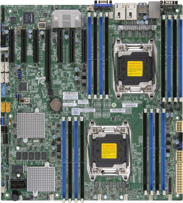

Motherboard "a picture is attached
It has the correct type USB and it does work as I booted from my TrueNas scale bootable usb drive as a test that it was working

The problem might be that the Motherboard is USB 3.0 and the USB enclosure is USB 3.1???
I have no personal experience on these devices.... but I would check on the hardware documentation.
