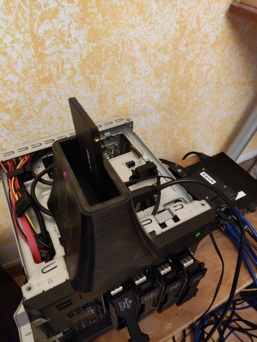

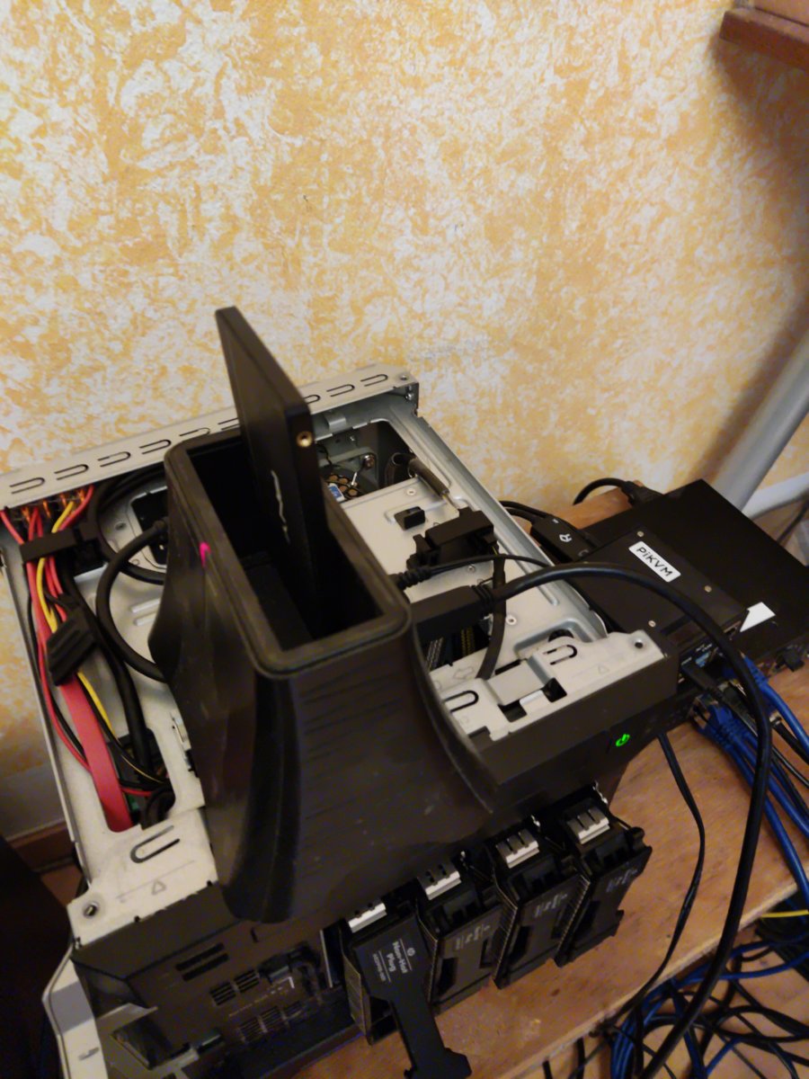

I found two more SATA to USB adapters and tried them both. The system is really booting from my not prefered one :-D.
@homer27081990 I apologize, you were right. It depends on the SATA to USB adapter, but it is still strange that it works with CORE and not with SCALE?!

Did you find a small mSATA to USB adapter that works? Or an M.2 SATA or NVMe adapter?
Look at my picture which one i have used :-D

Sadly yes. I also have a M.2 NVME to USB case which i will try next. Maybe this works...
edit: I did a clean install with the latest stable release and it´s also booting from the big dock. First i tried the lastest beta release in hope that it makes a difference.

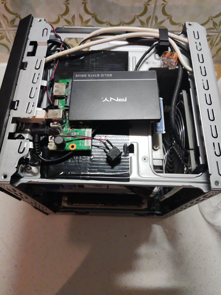

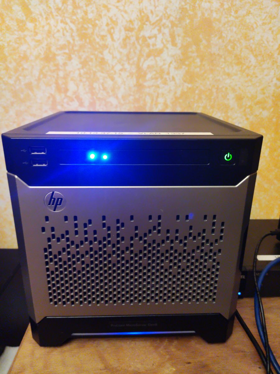

I found another USB to SATA adapter which is booting and i could sacrifice. This thing is from 2005! I bought it when i was studying in vienna. Its an old USB 2.0 adapter with an extra ESATA port. I drilled two holes in the ODD cover for the LED-lights so i also see if there is disk activity. It needs a 12 volt external powersource which i´m getting from the ODD-powerconnector.
