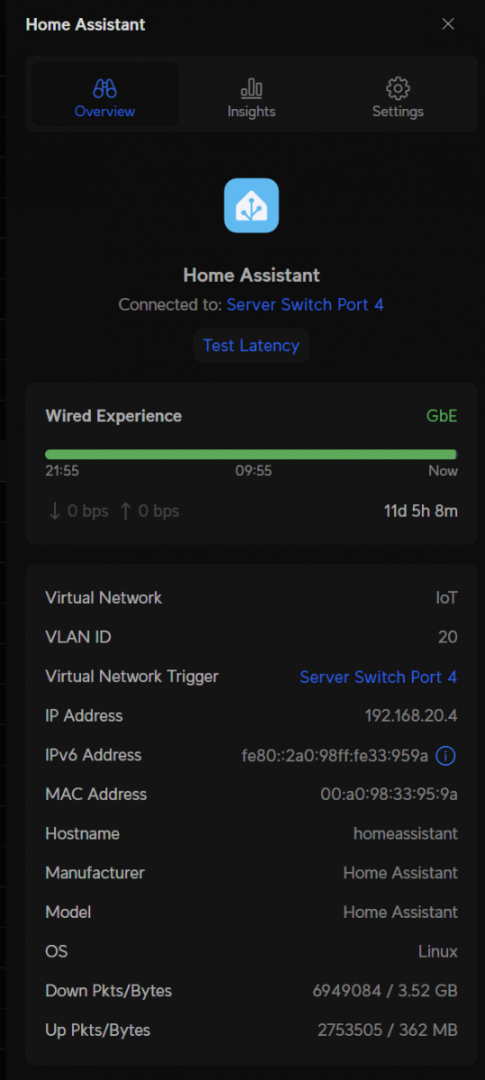

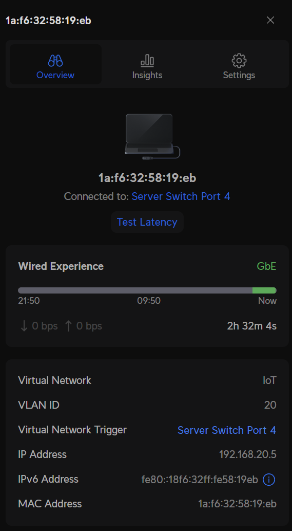

With my current setup I have a UDMP which I use to control all the static IPs on my network by using their MAC address which works for everthing as you can see what it shows below. But with the docker (app) it giving it a random MAC each time it starts. So only way is the edit the app settings for a static IP. The other screenshot is same way but instead of an app (docker) its using the VM instead.
That's not a static IP, that's a DHCP reservation. And that's not a great way of doing things for servers and stuff, so you really should set a suitable static IP address for the application.

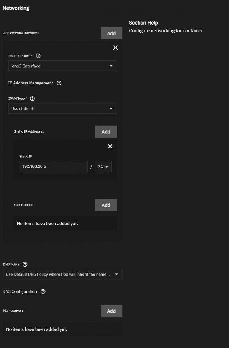

Yea it has a internal nic for the docker server then if you edit the config you can add one of the physical NICs which I have and set a static IP on this NIC but the MAC is random each time the docker is started. I have attached the settings for the NIC below. Would it be easier to redo it in a VM which then can control the NIC?
