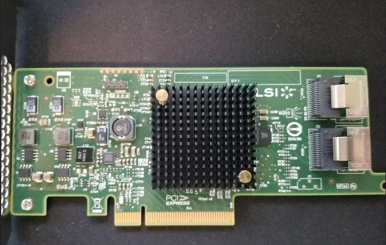

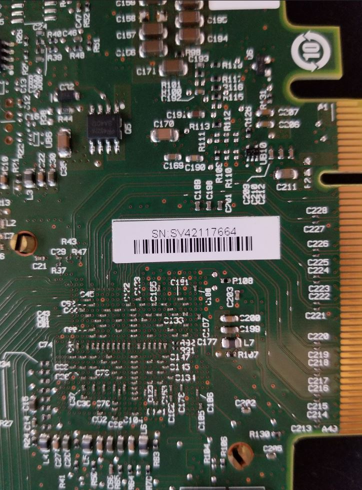

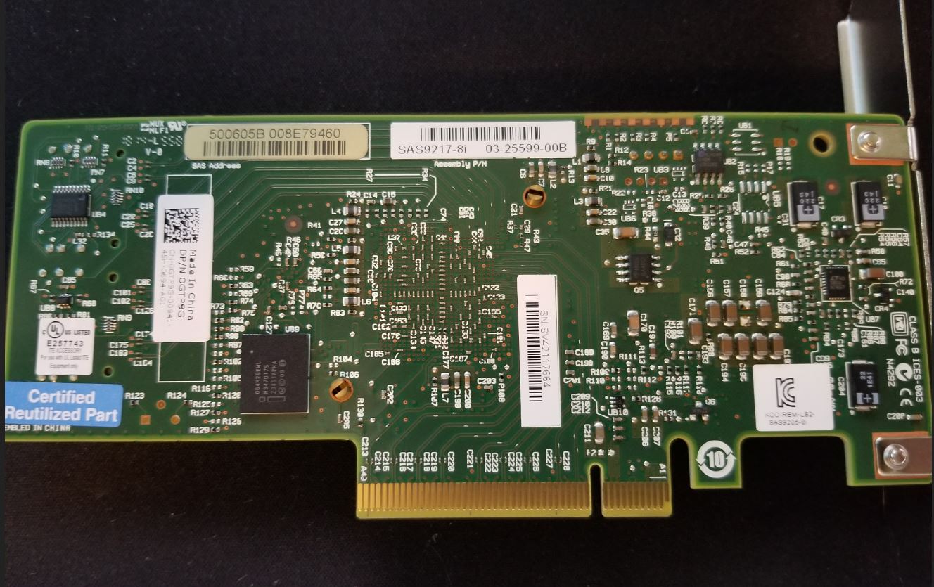

It arrived today, here are the pics, its also Reutilized

Looks original, similar pictures can be found online aswell. So happy testing ;)

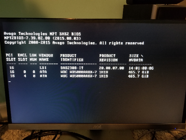

So question, here is a pic of the boot screen, it says IR on it so I figured I would have to flash, but when I got into FreeNAS it showed the 2 drives separate and let me stripe or mirror them however I wanted, so does that mean I dont need to flash the card?

So question, here is a pic of the boot screen, it says IR on it so I figured I would have to flash, but when I got into FreeNAS it showed the 2 drives separate and let me stripe or mirror them however I wanted, so does that mean I don't need to flash the card?
You will need to flash to IT mode.
https://forums.servethehome.com/index.php?threads/what-is-it-mode.328/
IR mode is not what you would like to have. The HBA is still doing some stuff on the hard drive and presenting a virtual drive to the OS.
If it's similar to the PERC H200/H310, the IR firmware on these cards will pass through unconfigured drives by default, but you likely still want the LSI IT firmware in order to have the latest revision and correct any bugs that were found and not patched in the Dell one.
I haven't crossflashed one of these cards specifically, so you might want to check for advice on this. It's a SAS2308 chipset, so don't accidentally use firmware or instructions for the SAS2008 series.

JACKPOT!! I ended up using the Dos Method to flash it from Broadcoms website but it says IT Mode
If anyone stumbles across this, these instructions were super easy to use and I just tweaked the files from the download page for my specific card.
https://www.broadcom.com/support/kn...mware-on-lsi-sas-hbas-upgraded-firmware-on-92
Now to start test data integrity
BTW, --checksum or -c on 200gb of data takes forever!
Thank you everyone for your help!

LSI confirmed the card to be be authentic and was sold inside a Dell server. I have done 6, 200gb rsyncs using
