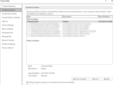

Hi Andrei,
Thank you. i went in and added the trusted location for word, excel, ppt. still no luck. i don't have a AD. this is for home use.
what else can i do to disable this "feature" from ms office? using guest access and no named users for home installation.

Hi jvedula,
Sorry for such a delayed response. But under the next tab down, under Trusted Documents you can completely turn off this feature and it won't require you adding any trusted locations. It will just stop checking for it. It can obviously be dangerous for some files, but if you have an antivirus running as well I think it will be ok.
Hope this helps.
