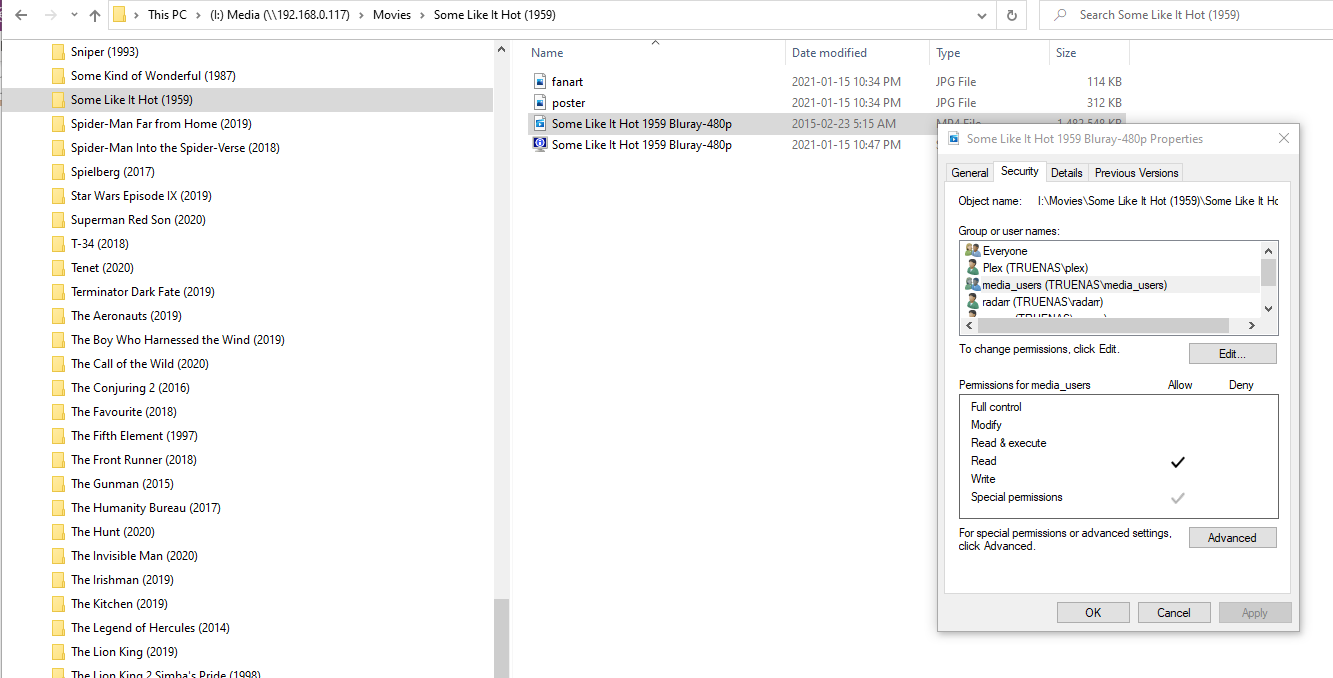

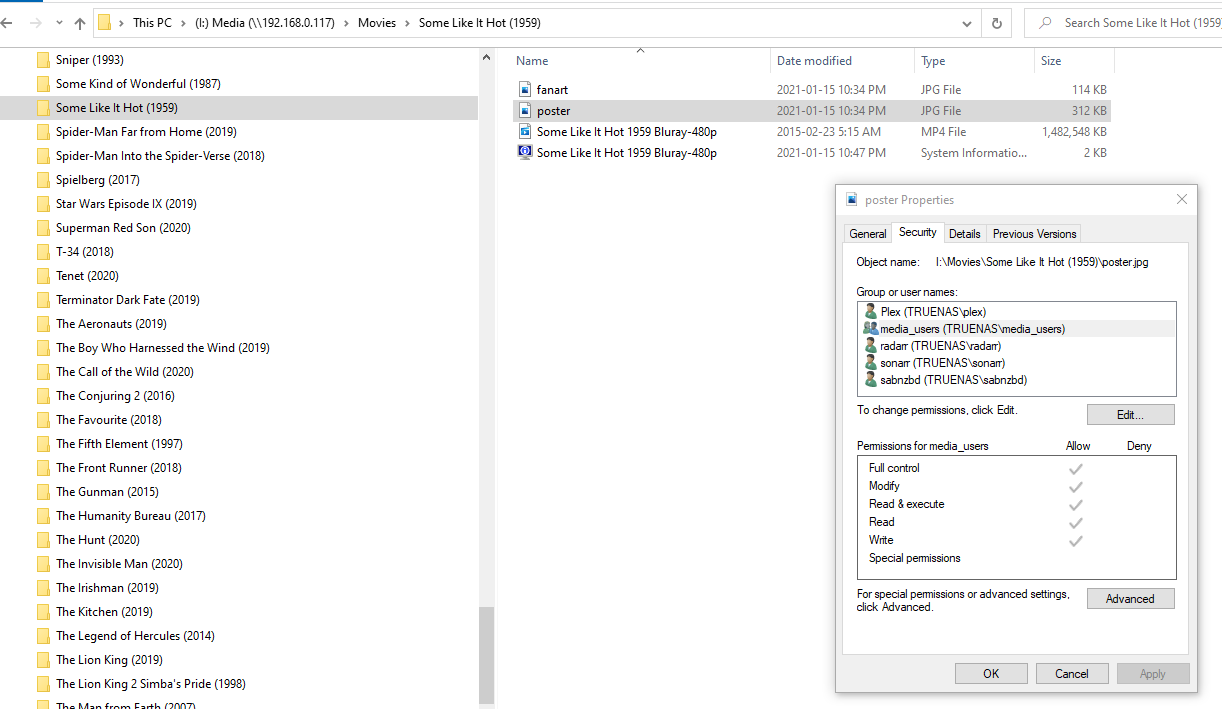

On TrueNas 12.0-U1, Sabnzbd 3.0.2, Radarr 0.2.0.1504 I am having an issue with the completed downloaded files on my media dataset where the video file throws an error "the permissions on ...... are incorrectly ordered". Yet the jpg and nfo files in the same folder have no such issue. When I do a properties on them via windows 10 on the share for windows.
On the TrueNas side, I am the owner of the dataset, and a member of the Media_users owner group and and set both with basic rights and full control with inheritance. The plug root users for Radarr, 352, and Sabnzbd, 350, UIDs have been dublicated on the TrueNas side and included in the Media_Users group. I have tried using 777 as the setting in Sabnzbd for "Permissions for completed downloads" and also independantly tried setting 664 as the "File chmod mask" on Radarr. Neither altered the perm issue with the video file.
This is what I expect my rights as owner of the dataset should be on a file in the downloaded movie directory.
But the video file in the same folder has these perms:
Any idea what the heck is going on?
