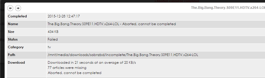

New install and just started to test last night. I confirmed CP and SR are grabbing nzb's and forwarding to SABnzb successfully. Now I am getting the following error on all my downloads,
Exit(127) env: python2: No such file or directory
I believe I screwed up my file system while following Joshua's blog/video.

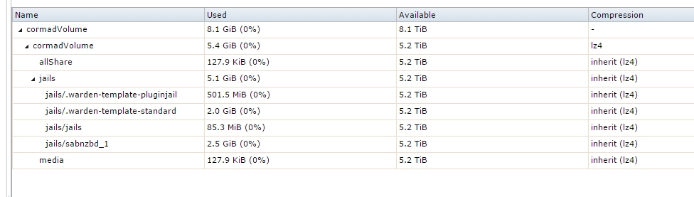

My issue (yup I have alot :)) is that /mnt/media doesn't exist. Here is a picture of my FreeNas setup.
My understanding is that all movies/Tv Shows would end up in the media dataset I created at the starts
cormadVolume/media

if you followed my blog /mnt/media should only exist in the jail, it's a mountpoint to /mnt/cormadVolume/media on the host.

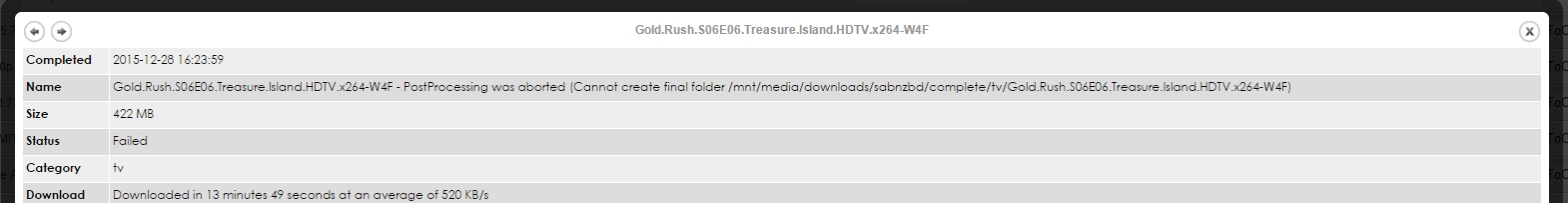

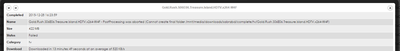

Ok, confirmed the folders are in the jail. Still confused on the original dataset (media) created before we created the jail, but moving on. Ran "pkg install python2" and tried again.
It appears SABnzb could not create folder ??
Permission issue??

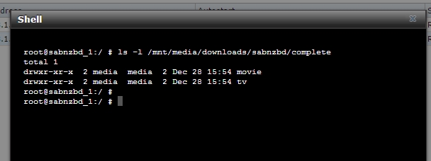

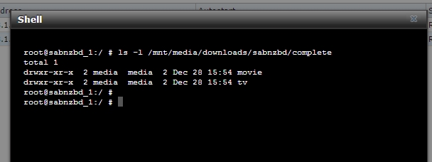

possibly is a permission issue. what's the output of this in the jail?
ls -l /mnt/media/downloads/sabnzbd/complete

looks fine to me, sabnzbd should be able to write in there. maybe check in there to see if a conflicting folder exists? or possibly it's a strange character issue, but doesn't look like it from the folder name.
