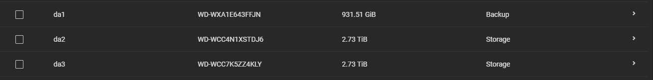

The 3 disks are identified as followed in Truenas:
And here is the kind of infos I can have for each of the 3 disks:
Issue is that when trying to run a S.M.A.R.T test on one of the 3 drivers, I constantly get the following error:
Whatever the kind of test I'm trying to run, the issue is the same.
Does any of you have an idea of where I should look at?
