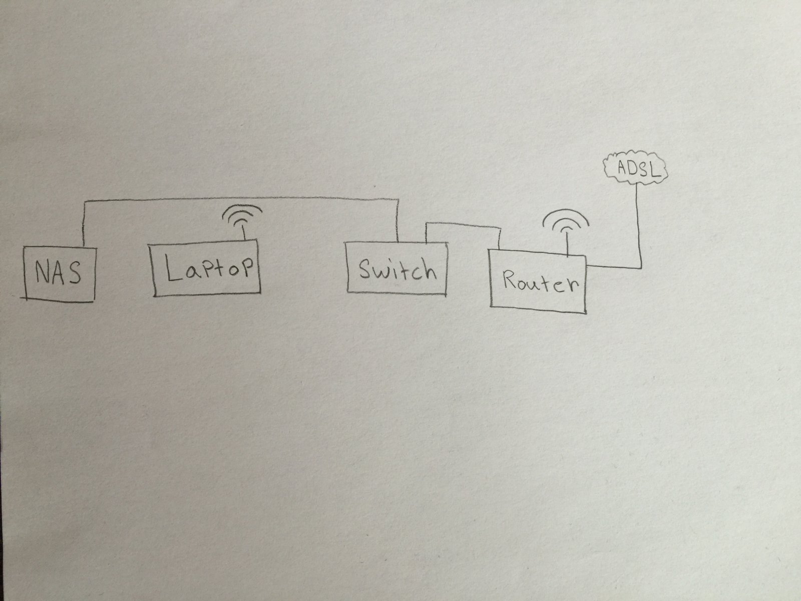

Alright. So lets say I buy a gigabit switch. Will the following setup work out well both for wired and wireless? Will my wireless speeds improve by any chance?

As I said in the other thread your ports are 10/100. At best, you will only get 1/10 the performance of a gigabit connection. As I recall your router is old, I believe it mentioned operating systems like Win 98...
The gigabit switch I mentioned would only help your wired connection. You could look at a new gigabit wireless router. It would probably support newer wireless standards. But, at the end of the day, you'll get much better performance on a wired gigabit connection, than using wifi.

That is true, but it's also possible to overdrive the receivers in the laptop and in the router, which can result in poor performance. It's a balancing act with many factors, some of which are unknown.
There are a total of three functions you're likely to need on your network. Many consumer-grade "WiFi routers" combine them into the same box, but they are distinct functions and should be viewed that way: (1) route traffic from your LAN to the Internet and back, usually doing NAT on the traffic so that all your devices appear as the same public IP address to the Internet; (2) provide WiFi connection to devices at your location; and (3) provide ports for wired connections. (1) is the job of a router, (2) is the job of a WiFi Access Point, and (3) is the job of a switch.
As I said, a lot of consumer-grade gear combines those functions into a single device. If you're using a reasonably modern, decent quality device, that isn't a terrible thing. But since we tend to be hardcore geeks here, a lot of us prefer to separate those functions, having a single device do each one. That way, we can optimize each device for our needs, and upgrade/repair/replace only the parts that are necessary, when it becomes necessary.
For the router, there are tons of options. I run SME Server 9.1 (www.contribs.org), a customized CentOS Linux distribution which acts as a router/firewall and mail/web/FTP/file server. I've been using it for about 15 years now, and it's met my needs very well. A number of folks here run Sophos UTM or pfSense--both of these, unlike FreeNAS, can be run on pretty much whatever old hardware you have laying around. I've seen some recommendations lately for the Ubiquiti EdgeRouter Lite, which sounds like a pretty nice box for $100 or so.
For a WiFi access point, there's kind of a dearth of consumer gear that's sold specifically as a WAP, but any "WiFi router" can be used as a WAP by only using the LAN ports on it, and disabling the DHCP server. Or you can step up to "prosumer" gear like one of the Ubiquiti UniFi access points--teh hawtness right now would probably be the AC Pro, but there are a number of other devices at varying performance levels and price points. I'm using one of their older model access points, and it does quite a nice job.
On switches, there are more options than can be counted. It's unlikely that you'll have any need for a managed switch, so really what you're looking for is a Gigabit switch with the appropriate number of ports. These are pretty inexpensive.

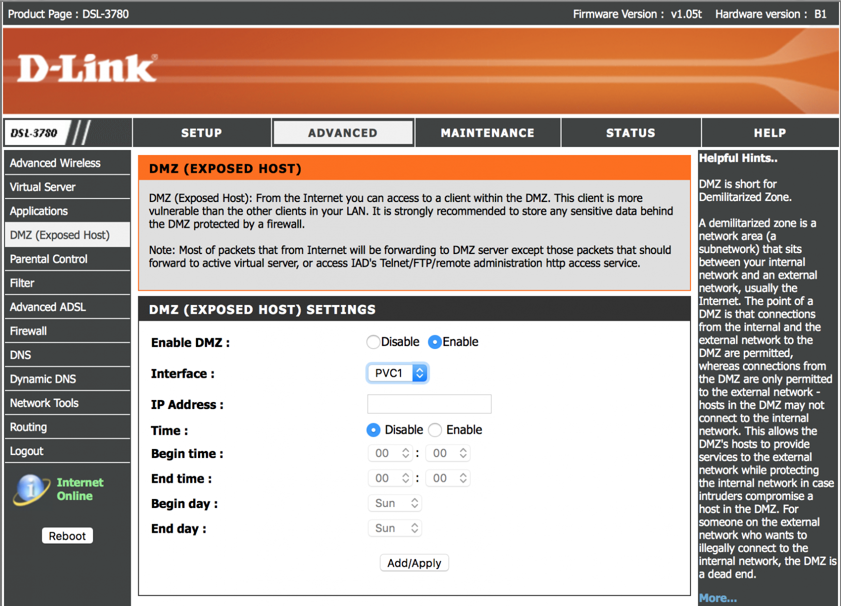

NAT = Network Address Translation. If you want to forward a port it will be nothing but an issue.
INCSlayer beat me to it though
And you could just buy one outright, search for a D-Link DSL-2320B, then pair it with a router like the ASUS N66U

My provider probably wouldn't have any dumb modems to sell me. It's not like in the 90's... They have everything built into one product these days >_<
True, but you can likely call them and convince them to put your modem/router in bridge mode so you can use your own router/firewall.

the DMZ only works for one ip address so that doesnt really solve the issue especially if you use multiple jails
