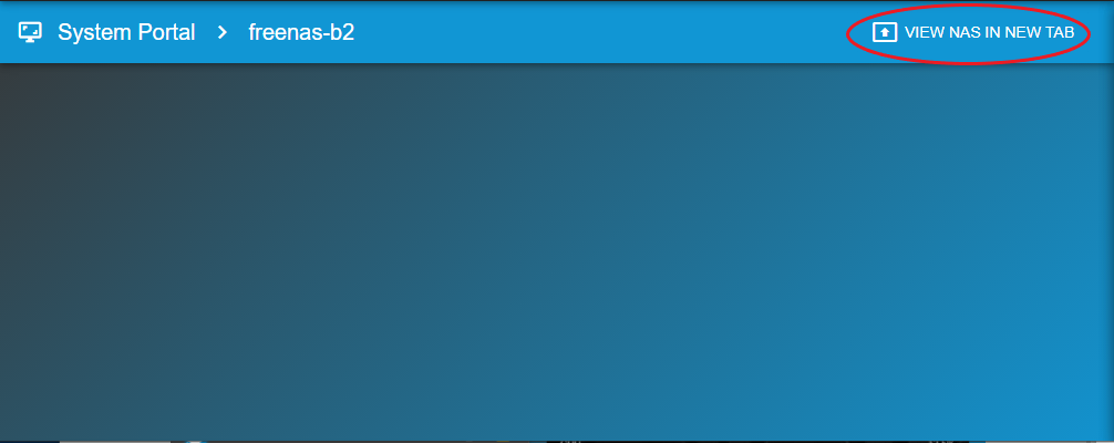

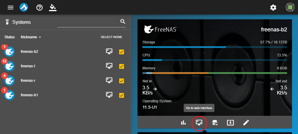

There is one anomaly though. If I select 'Go to web Interface'...
I end up with a blank screen, which I can get past by selecting 'View NAS in new tab'.
It's a small price to pay to avoid having to remember the IP: port.
