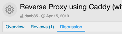

15,504
Yeah, I should fix that. Click "Overview" at the top of the screen to get there:
