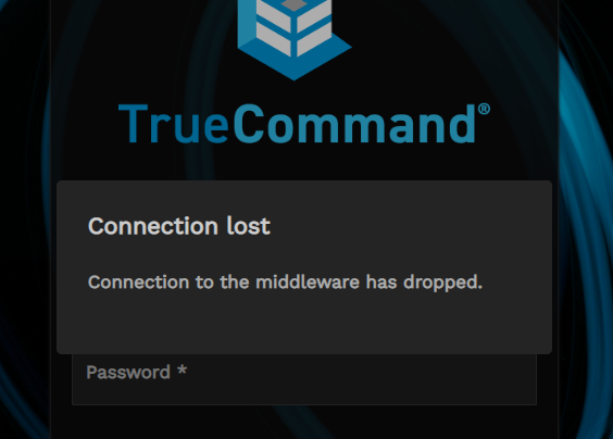

Did anything else change from 2.2.2 to 2.3.0? WIth 2.2.2, I have my TrueCommand working behind a nginx reverse proxy server, running with no issues. Websocket support is enabled. After upgrading to 2.3.0, can no longer access TrueCommand via reverse proxy.
If you go to https://truecommand.domain.com, it sends the request to https://truecommand.domain.com/auth, which then displays:

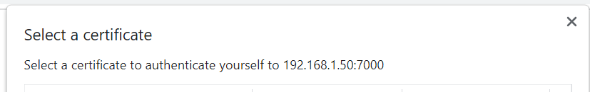

However, from my nginx container, I can access the host with no problems. It seems to be an issue with SSL certificates, as attempting to access the page via https://IP:7000 (Port forwarded to 443), I'm prompted to select a certificate to authenticate with:

A fix for a related issue in 2.3, where we set explicit client auth verify_if_given for HTTPS, resulted in a strict SNI check, throwing 421. We have a fix in 2.3.1. A temporary fix is to removed the client_auth block from /etc/Caddyfile or add servers { strict_sni_host insecure_off } in the root block.

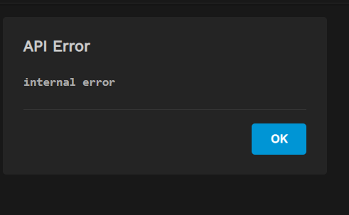

So, after removing the client_auth block, I can now log into TrueCommand, *sorta*.
I can login just fine via local username/password. However, if I attempt to login via SAML, I get the "API Error - internal error" popup.
If I login using the local account, and go to Administration -> Configure, and try the SAML Identity Provider Metadata XML File Upload' and upload the valid XML Metadata, I get the same popup. I'm attaching some logs, if more are needed please let me know.

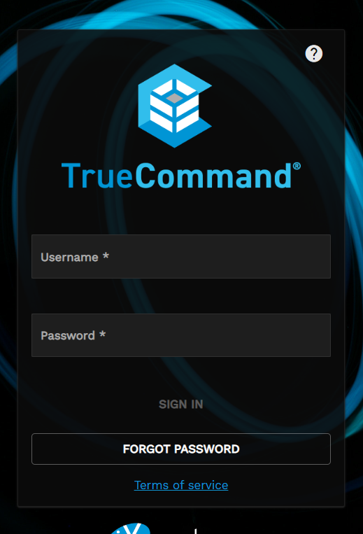

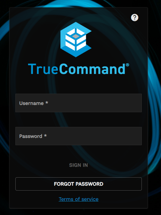

So the first time attempting to connect to TrueCommand, the SAML Login button is not available:

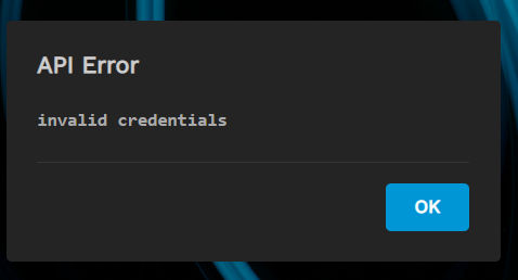

After refreshing (sometimes twice), the SAML option is available, but does not work. Not sure what has changed from 2.2 to 2.3, but I get these two popups:
So I went and checked, and the user has somehow been marked disabled. Not sure how this happened from 2.2 to 2.3, as if I launch the container with 2.2, the user can authenticate fine. There is also no way to mark an inactive user active, outside of removing the user and re-adding it seems. Completely deleting any users created via SAML fixes this problem. There should be a way to mark an inactive user active, which would fix this problem but not explain it.

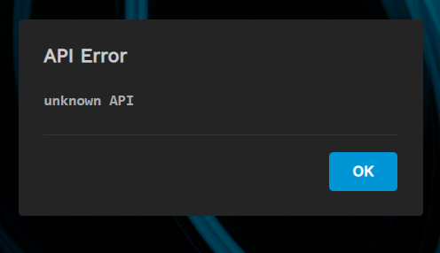

And, attempting to update the SAML Config results:
Also, attempting to add System Groups causes errors as well:
