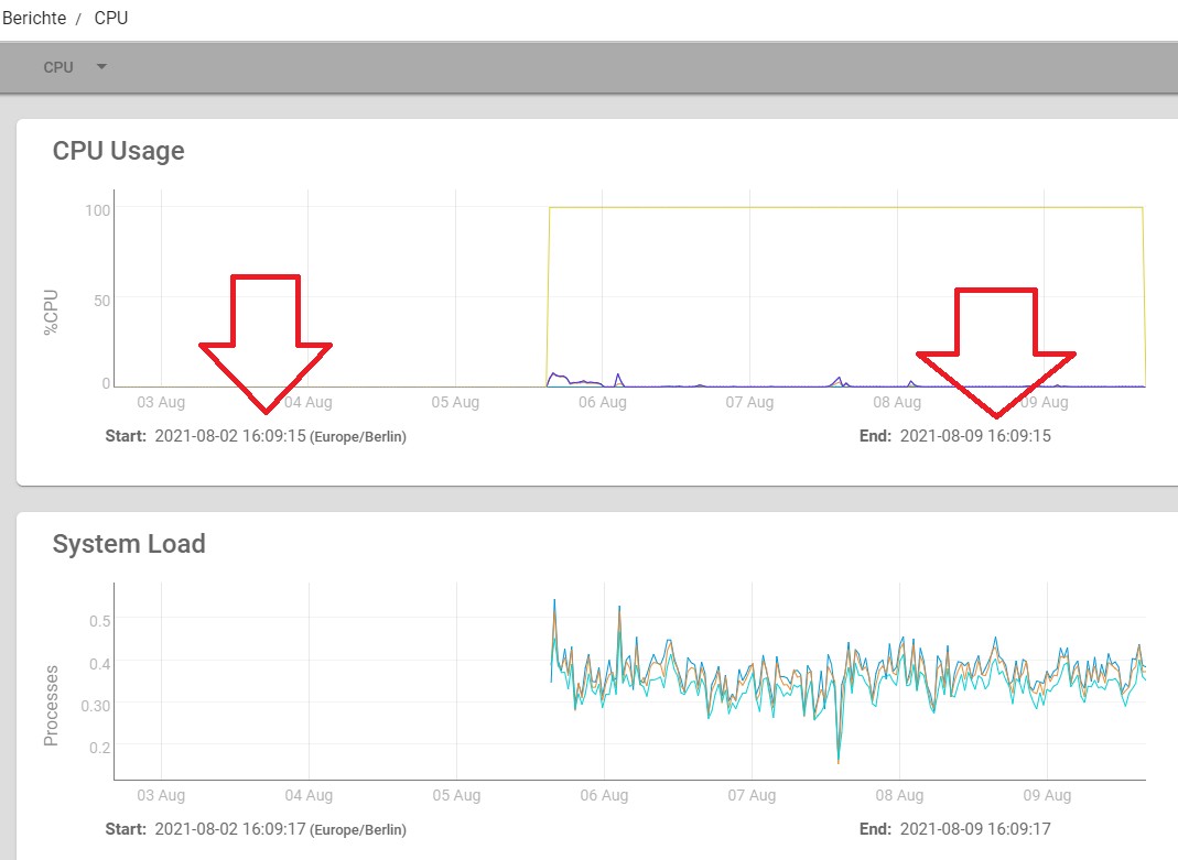

So I'm using TrueNAS since about one Month now and just found out that the reporting is only working for exactly 7 days!
See screenshot attached:
I could not find any setting in the menue, also not in this forum or the documentation which tells how to change the log time.

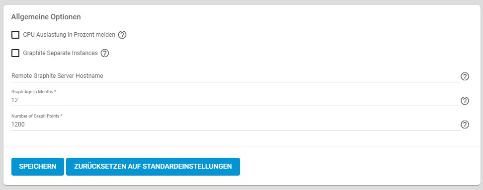

If I check the settings, it tells me that its storing the data for about 12 months.

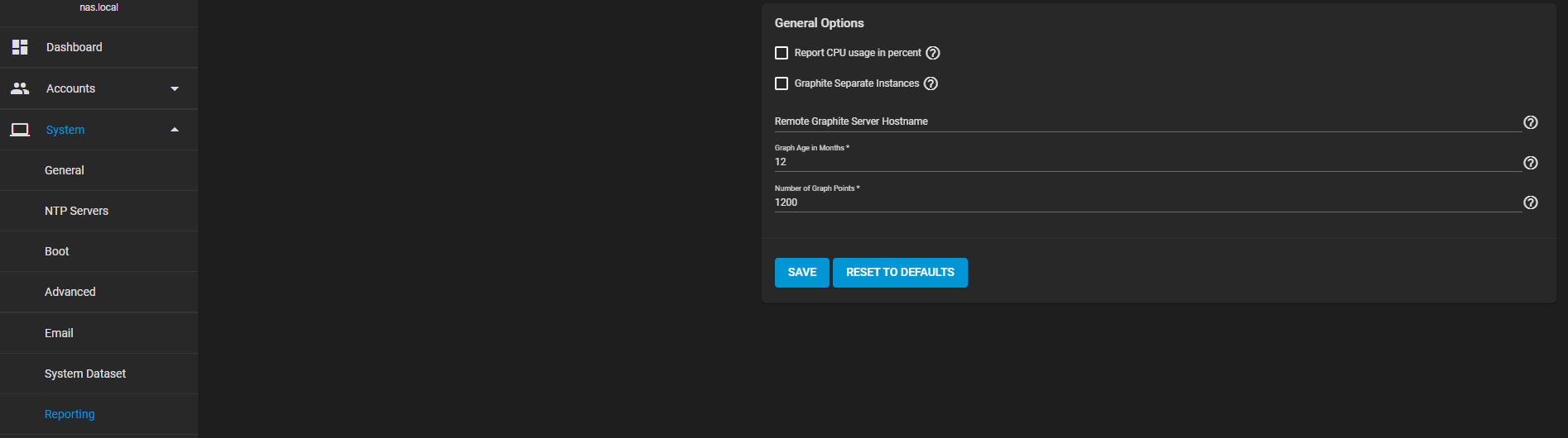

I'm not able to recreate your situation, I see 6 months worth of logs.
When you checked the settings, are you referring to the reporting settings in Settings > Reporting?
If it helps, this is how mine is configured. I haven't touched these settings.

For me it's exactly the same setting as yours. The uptime is currently 10 days, but I only get 7 days of reporting. It seems like everything before gets deleted or something. I have no Idea how I could check this... I mean, maybe there is some kind of a config file or so, where this is set. But this is not documented :(

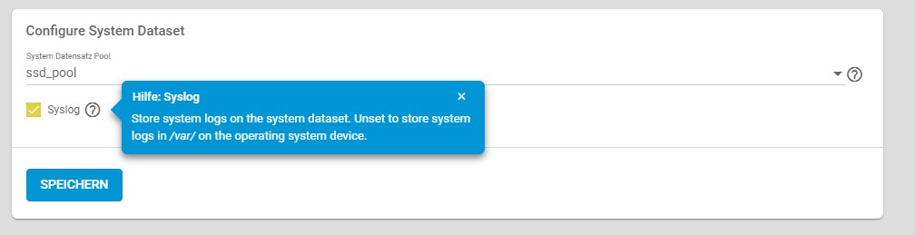

Yes, its written to the data pool (RAID-Z1):
But same here: the help function is not really helpfull as I don't understand if I should check the box or not. Currently it is set like above.
It's not stored on the boot pool.
Do I need to store it on a differend location then the "user data" ?
I mean I really don't get it, as there is enough memory (RAM and disk).
