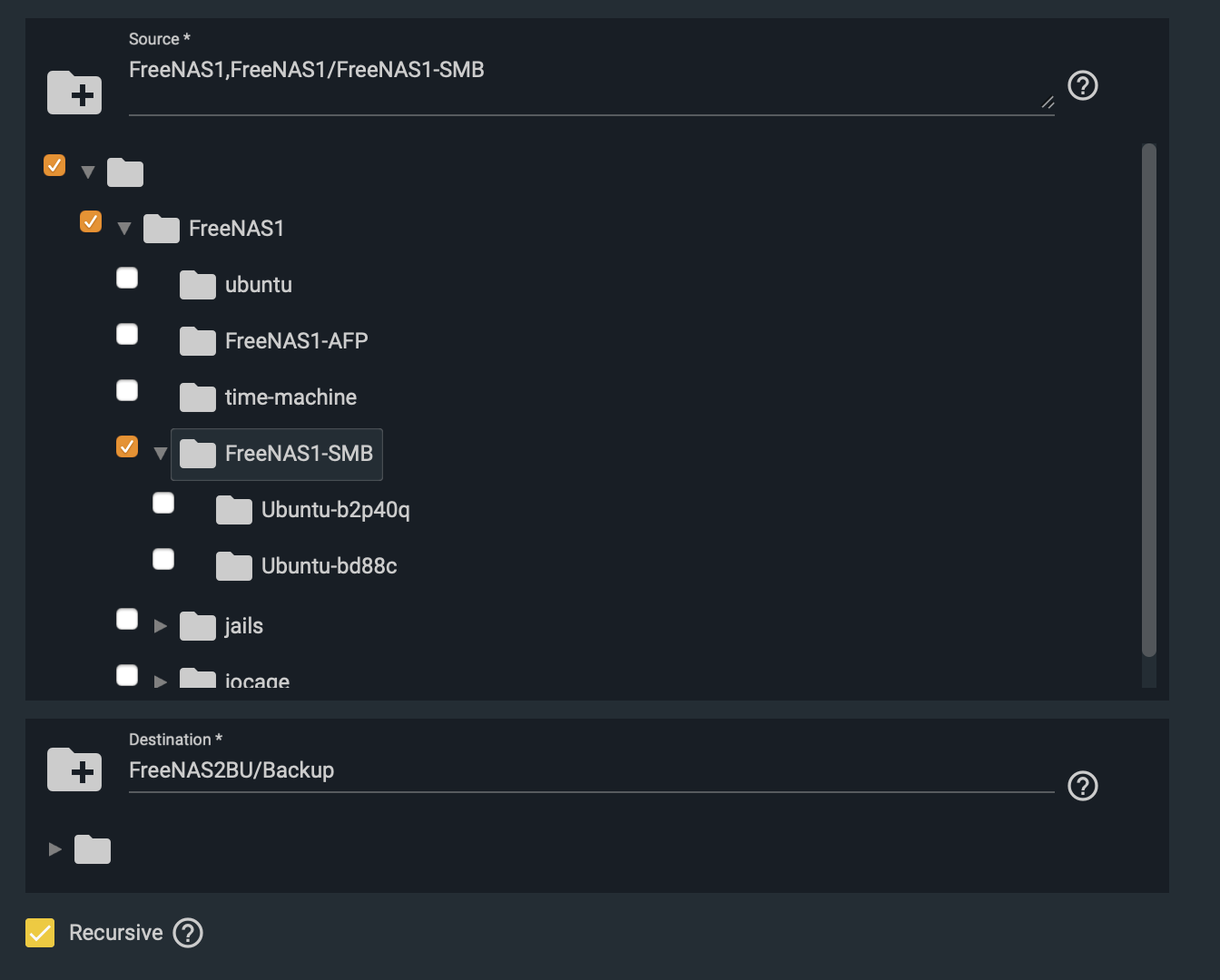

I setup a Replication task to send all of the data in the FreeNAS1 dataset (the topmost dataset) to the FreeNAS2BU/Backup directory on the 2nd server. After it ran I saw I was not getting all of the directories.
What I noticed was that the Replication setup was not seeing all of the directories, sub-directories and files. Figure 1 shows what I selected but the FreeNAS1-SMB share doesn't have any of the relevant subdirectories.

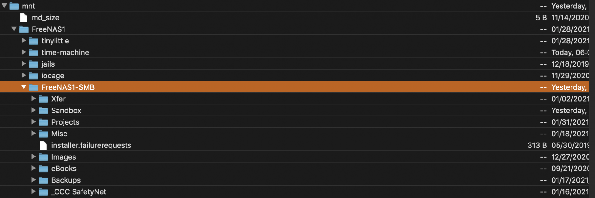

Figure 2 shows the sub-directories that are there when I access FreeNAS1-SMB via SSH or via a mapped drive.

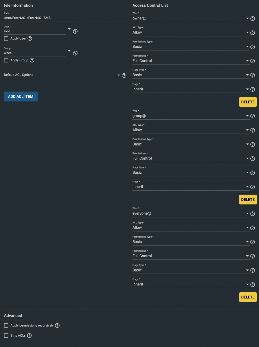

Figure 3 shows how the FreeNAS1-SMB is setup.
My guess is that there is a problem ACLs or permissions, but I'm having trouble tracking it down and would appreciate some guidance from the community.
