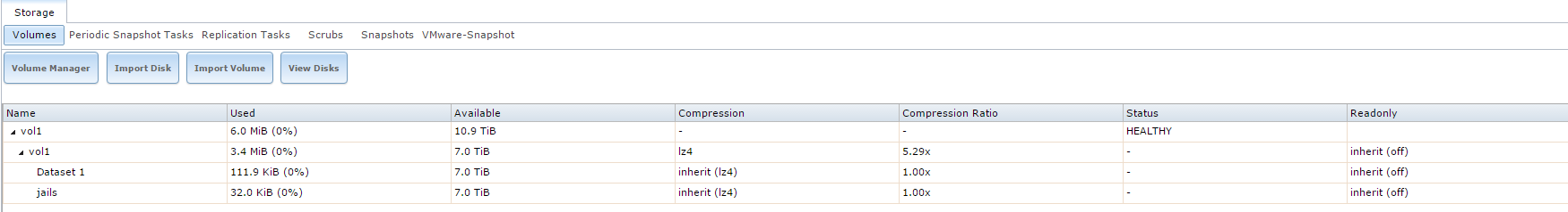

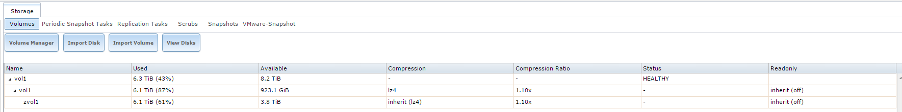

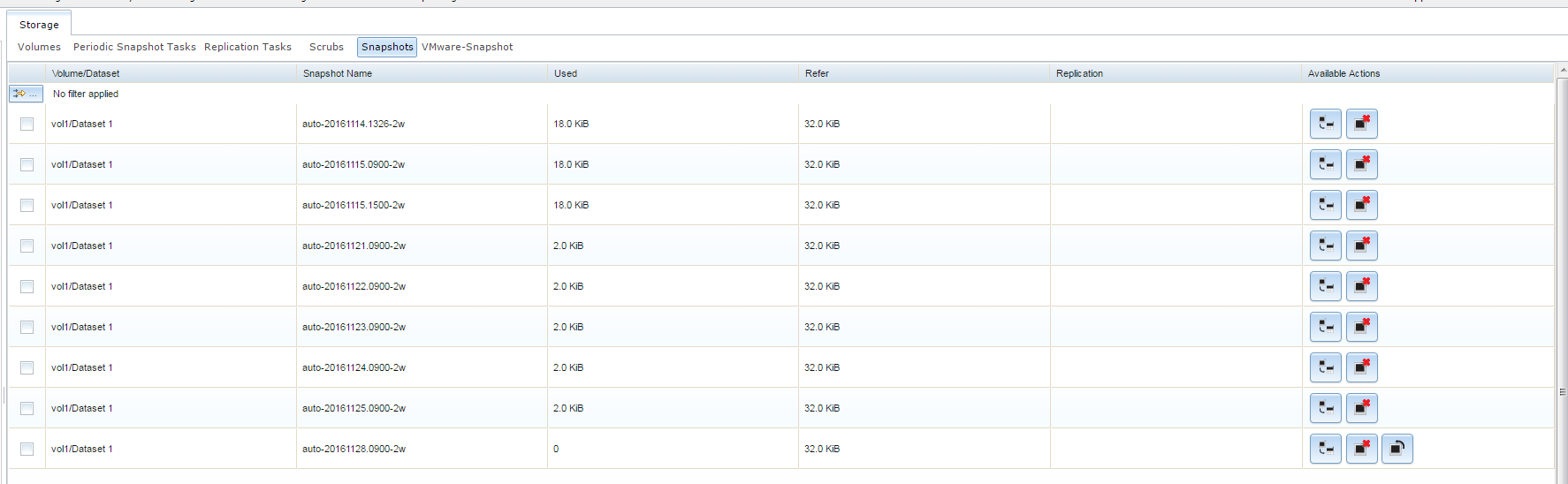

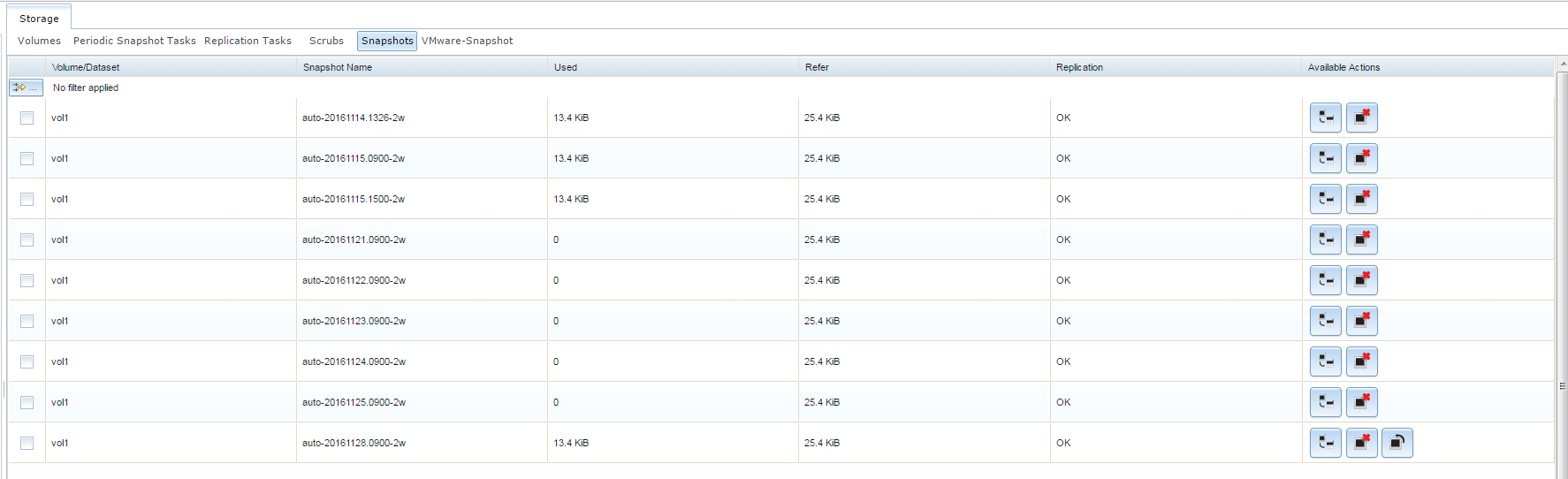

freenas1 was setup to be the target for snapshot replication from freenas0 and it works......sorta. I had my graphics lady dump a file in a CIFS folder to test the snapshoting and replication and it works! But for some reason it will not snapshot and replicate the zvol on freenas0!
I have read through many DIY's and followed everything to the letter and I am still getting nothing! I have been wondering if it has something to do with the way the windows server "hides" its backups from sight of average users"
I will attach photos of the settings on freenas0 and freenas1
I might be wrong, but I think zvols are treated like datsets, so since you have recursive snapshots disabled, you aren't snapping the zvol, and therefore it can't be replicated.
Either enable recursive snapshots on vol1, or create a new snapshot for the zvol. And then make sure either child dataset replication is enabled on vol1 or create a separate replication task for your zvol.

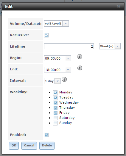

skinny503
Nov 16, 2016
22
Depasseg,
I was told in my last thread to set the permission recursive and I did, still no replication.
I changed my SS drop down from vol1 to vol1/zvol1 and still nothing.
I have attached a picture of my current SS settings on freenas0.

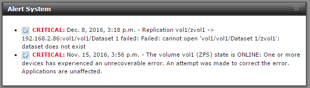

So I just checked my errors and saw this. it looks like I need to do some configuring on freenas1 and it might work? thats a job for first break time so I can hide in my server room and be left alone :D

depasseg
FreeNAS Replicant
Sep 16, 2014
2,874
Yep - create dataset1 on the destination. Good luck. And you might want to consider renaming your systems so they aren't the same. having "vol1" in multiple places can get confusing down the road when you forget what you've done.

I created a zvol1 in freenas1. The error now reads
  • CRITICAL: Dec. 6, 2016, 4:24 p.m. - Replication vol1/zvol1 -> 192.168.2.86:vol1/Dataset 1/zvol1 failed: Failed: cannot open 'vol1/Dataset 1/zvol1/zvol1': dataset does not exist
Is there something im missing here?
depasseg
FreeNAS Replicant
Sep 16, 2014
2,874
you are missing the zvol1 sub dataset on the destination.

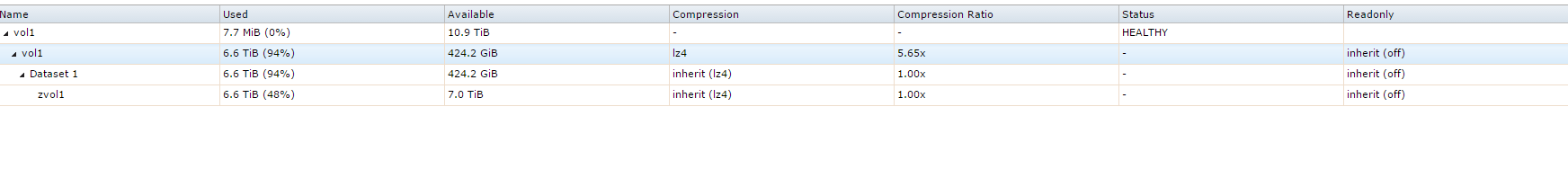

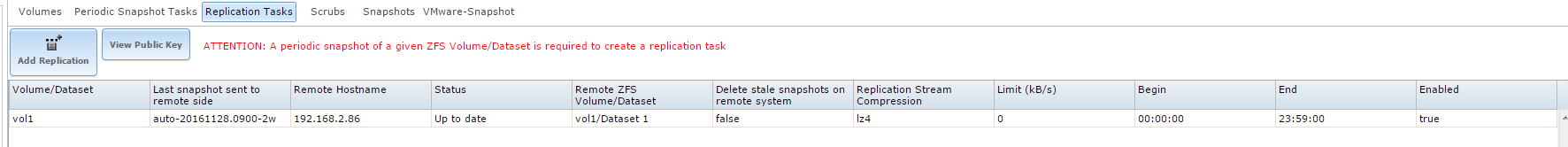

So I have corrected the error I believe but its still not working? I will attach pictures of the error, the snapshot replication on freenas0 and the storage on freenas1
skinny503
Nov 16, 2016
22
So as far as I can tell everything is set up correctly. Any insight?

I would advise against using a space in a dataset name. And have you verified that the dataset on pull exists?

I was able to get the error to go away last night after reading a few forum post and a few different versions of the FreeNas manuals. So the error is gone and everything is working for replication.
The problem still exists that its either not backing up the zvol (which I dont think is the issue) , or something is hidden about the windows updates and its not copying them..... So frustrating right now.
