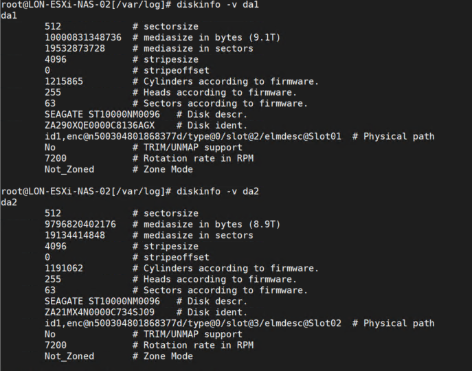

Yeah, it's a bit frustrating, here's some more info if someone could point me in a direction:
da1 is the disk I'm trying to add.

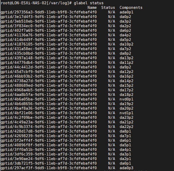

what does your glabel status look like?

Here's the glabel status

Well, you say you've been careful, but from what I can see, you were doing this:
zpool attach poolname da2p2 da0p1
I think you wanted it to be
zpool attach poolname da2p2 da1p?
Problem is that I see no such partition for da1... have you partitioned it at all? (or can we just not see it in your screenshot?)
