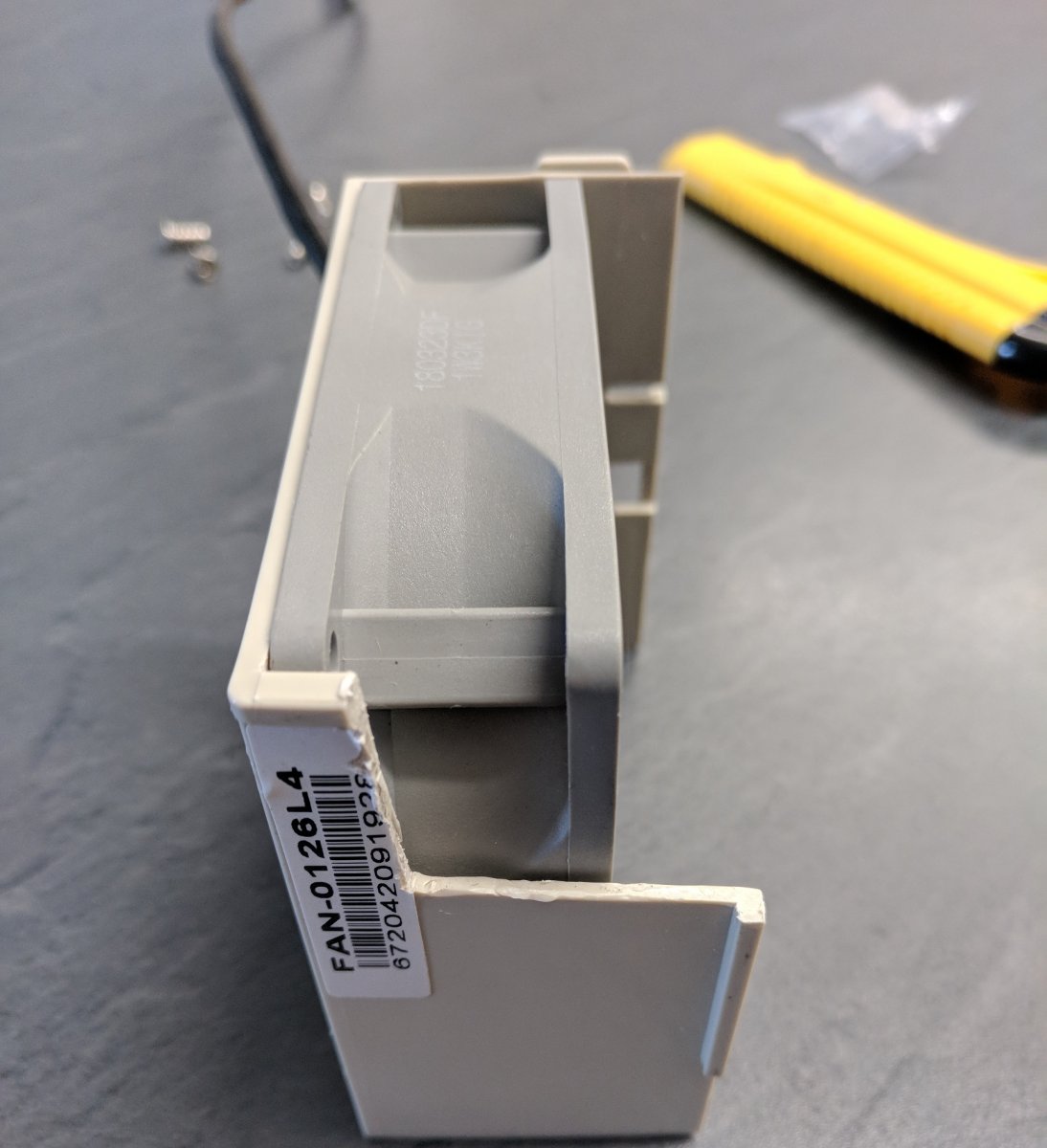

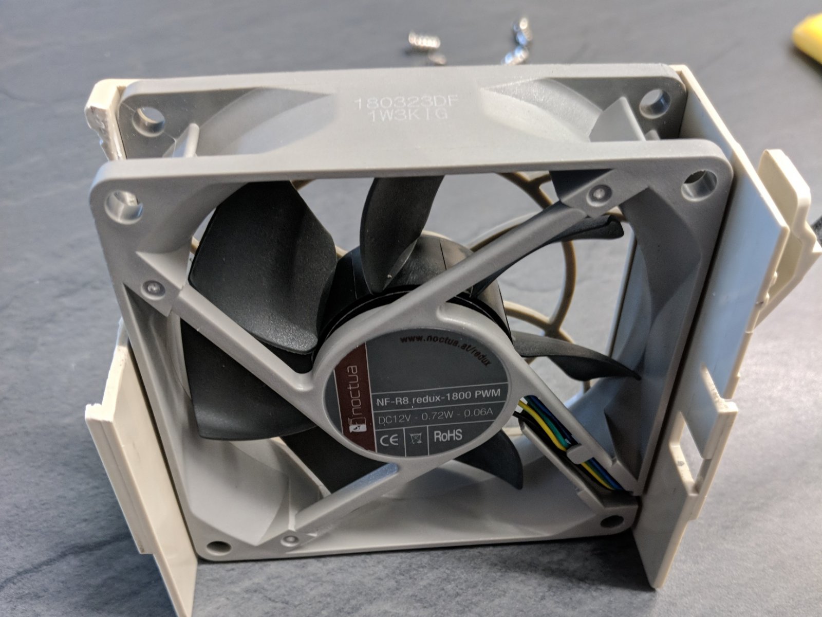

thread old, but topic fits. This is a kind of "kids, don't do this at home", "watch your step" and "use at your own risk" ;)
Will make it short and simple. replaced all fans in the supermicro 836 chassis with Noctua NF-R8 redux-1800 PWM. Results:

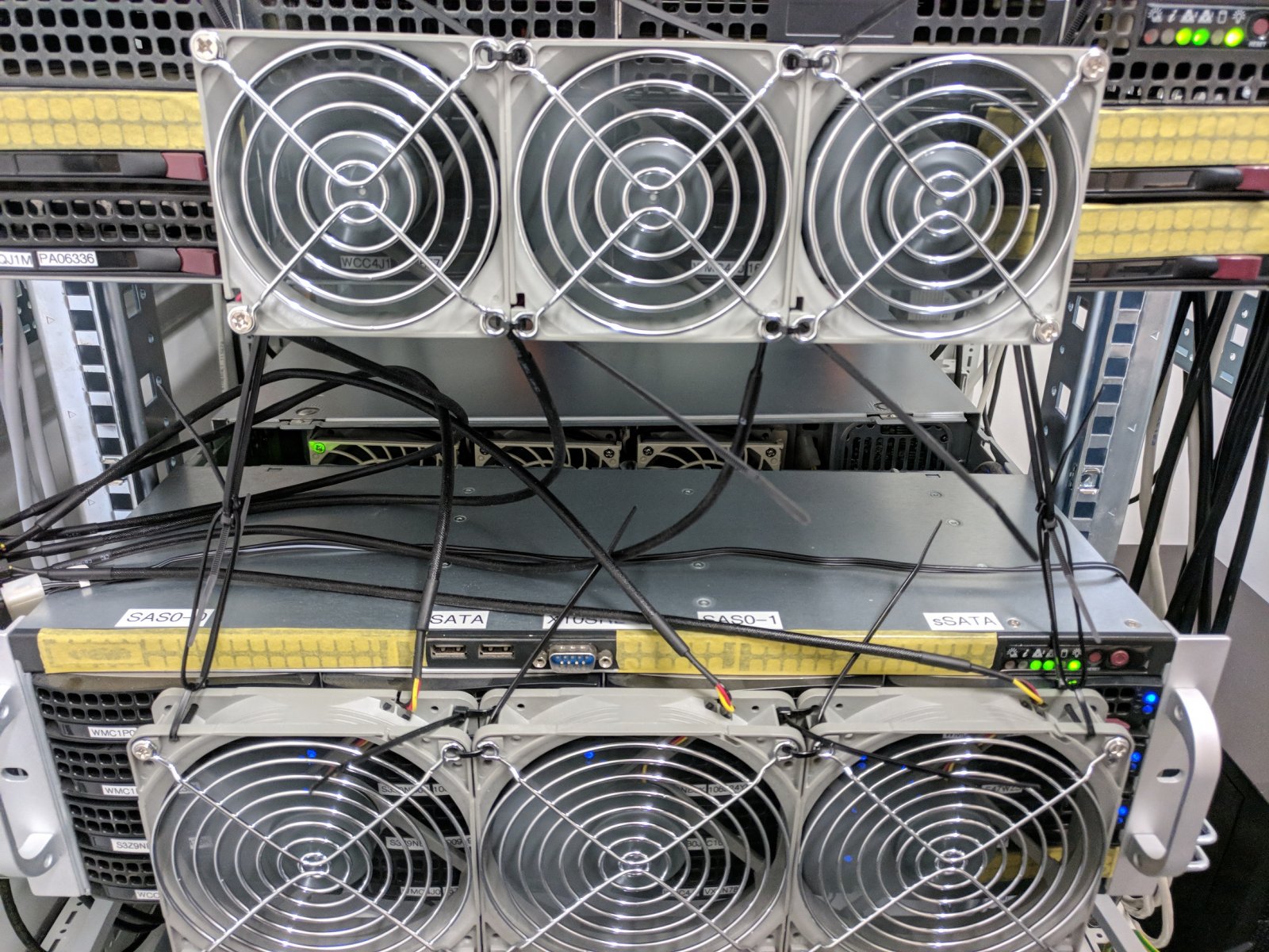

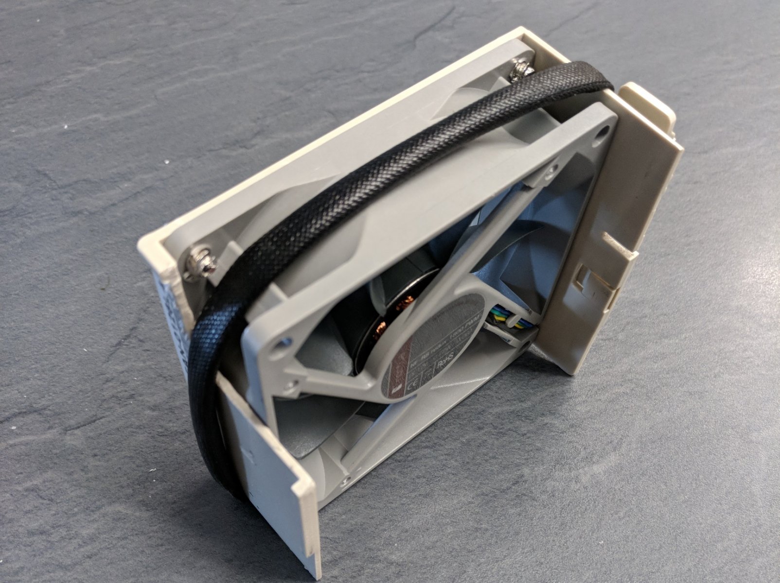

and this is ultra professionell. Should be used by everyone in production:
(case is open because this was in the middle of the modifications. The rack is only a temporary one. It is too short in depth)
(3x Noctua NF-R8 redux, 3x Noctua NF-R12 redux)
:eek:
Yeah, does not look nice, but works. If someone has an idea, which does not require a 3D printer, you are welcome.
Got -1°C on all HDDs/SSDs compared to the default 0126L4. Next week I will replace the 0125L4 in the back.
Of course, system is running at "Full Speed" to use fans at max speed.
