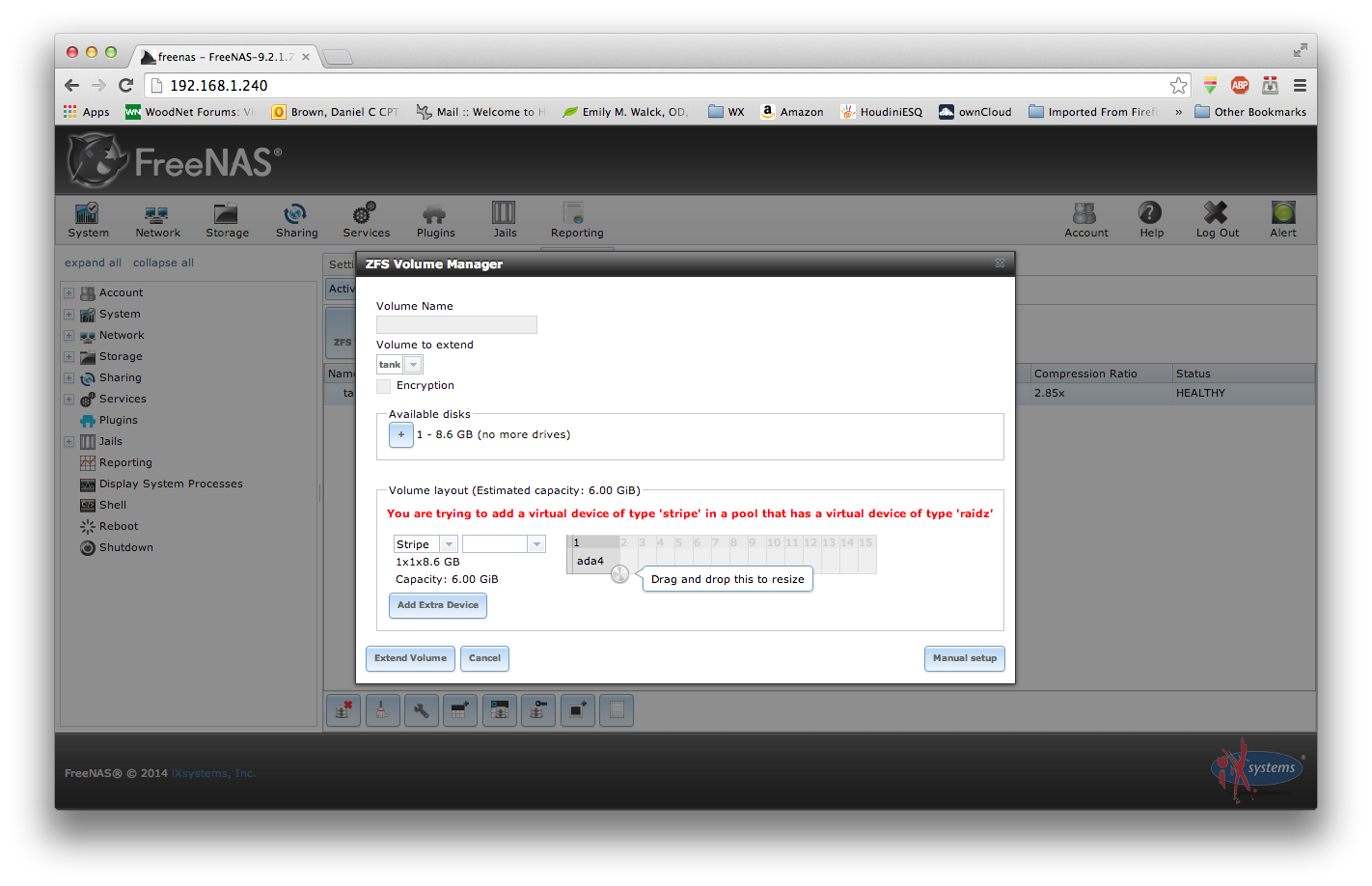

Well, that's what I get for submitting a bug before testing... At least in 9.2.1.7, the warning is already implemented, and it looks like it does not even allow you to do this within the ZFS volume manager. See the attached screenshot. To create the problem seen in this thread, you have to go into the manual setup window.
Nice touch, that warning.
