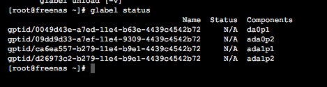

So far so good. On to the zpool attach command. Here is my glabel status:
Ok I know my original disk is ada0p2 from the Volume list but how do I know which which of these gptids is correct for my new disk? Sorry total noob. My guess is ada1p2.
mjws00
Jul 25, 2014
798
Correct
