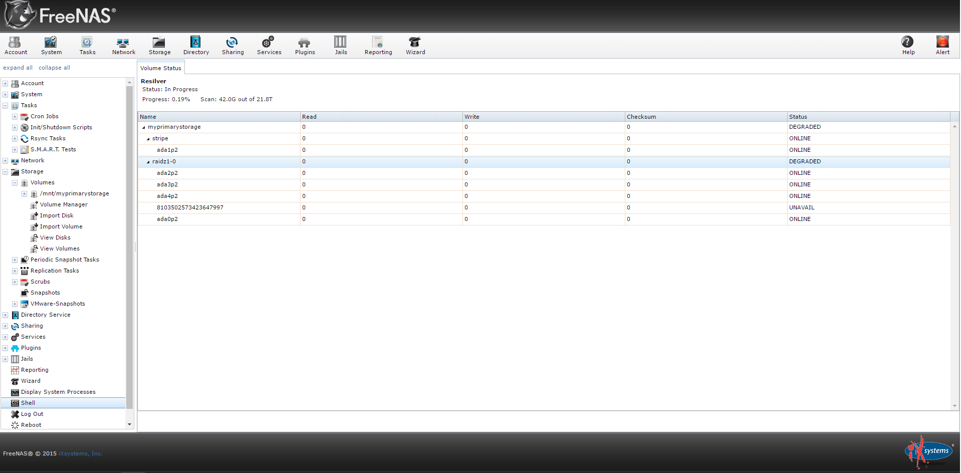

Situation: FreeNas GUI reported that a pool was degraded. This also coincided with the pool being too full, so I had a disk handy that I could add (which was recognized as ada4) . Via the gui, I did the following:
->Clicked on the Storage Tab
->Selected my volume (myprimarystorage)
->Clicked 'View Status' at the bottom of the page
->Selected the degraded disk (8103502573423647997)
->Clicked on the 'Replace' option at the bottom of the page
->Selected the new disk (ada4) and clicked on 'Replace Disk' to start the process.
The process seemed quite slow, so I checked around on the forums and ran the following command to find out more:
zpool status -v
To get the following output:

  pool: myprimarystorage
state: DEGRADED
status: One or more devices is currently being resilvered.  The pool will
		continue to function, possibly in a degraded state.
action: Wait for the resilver to complete.
  scan: resilver in progress since Tue Apr 18 11:39:22 2017
		51.5G scanned out of 21.8T at 10.4M/s, 607h53m to go
		11.0G resilvered, 0.23% done
config:
		NAME											  STATE	 READ WRITE CKSUM
		myprimarystorage								  DEGRADED	 0	 0	 0
		  raidz1-0										DEGRADED	 0	 0	 0
			gptid/fbb02c3d-b16f-11e4-9823-bcaec543a0ab	ONLINE	   0	 0	 0
			replacing-1								   UNAVAIL	  0	 0	 0
			  8103502573423647997						 UNAVAIL	  0	 0	 0  was /dev/gptid/fccbf3d0-b16f-11e4-9823-bcaec543a0ab
			  gptid/d8786603-23d7-11e7-a9f9-bcaec543a0ab  ONLINE	   0	 0	 0  (resilvering)
			gptid/fd2c3e81-b16f-11e4-9823-bcaec543a0ab	ONLINE	   0	 0	 0
			gptid/fd9598aa-b16f-11e4-9823-bcaec543a0ab	ONLINE	   0	 0	 0
		  gptid/7deafcdf-1ed5-11e5-8938-bcaec543a0ab	  ONLINE	   0	 0	 0
