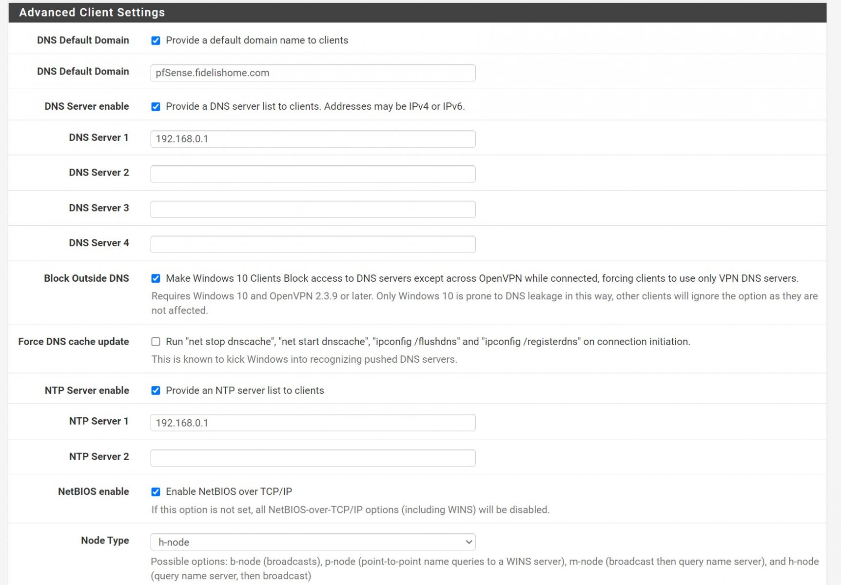

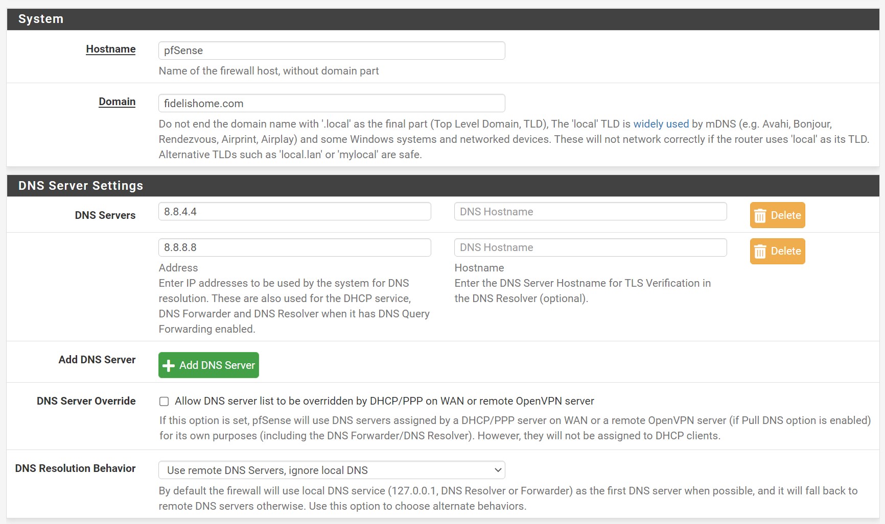

Hi Patrick! Thanks for the insightful information. You definitely enlightened me that there are numerous ways to map shared drives. Until now I had always just hit the "Browse" button next to folder name and selected the network device which I now know only maps based on network name (in this case it mapped as \\TRUENAS\). Apparently, that created issues. I now mapped directly to the IP address which seems to resolve the issue.
My TrueNAS server is on a dedicated IP which never changes, therefore anytime I now VPN into the network I should have direct access to the shared drives using the IP assignment. I've never had any issues not being able to ping (or see) the IP behind the firewall.
I did take your advice and checked the DNS settings and found something interesting...which I'd appreciate any further guidance/feedback.
In my pfsense DNS settings, under DNS Resolution Behavior I have it set to "Use remote DNS settings, ignore local DNS" and have 8.8.4.4 and 8.8.8.8 set as my DNS server(s).
However, under the OpenVPN settings in pfsense I have DNS default domain checked so that a default domain is provided to OpenVPN clients. Also, DNS Server is enabled so that my pfsense server provides DNS services to clients. SEE ATTACHED SCREENSHOTS
I suspect this may have been causing part of the issue I was having. Should I change the OpenVPN DNS settings? If so, how?
