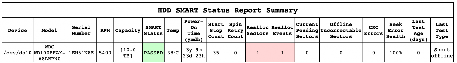

I'm using
https://github.com/dak180/FreeNAS-Report, which is different than I think Multi-Report? Link to where I can find Multi-Report so I may understand the differences?
Yes, there are portions of my code in the FreeNAS-Report script which is why it looks so similar to Multi-Report. There are some differences under the hood but overall function is the same as Multi-Report, however Multi-Report can be heavily customized. I'm working on a new tool to make the customization easier, but that is at least a month away as my day job interferes with writing code. But they ultimately do the same thing and if you are fine using FreeNAS-Report, you should continue to use it.
@dak180 has done a very good job on this script, keeping it up to date, and I even took some pointers from his code as well. The hope is that one day, TrueNAS will implement enough of these features so we no longer need these scripts.
The testing results are very good for your hard drive, I'm glad it passed the long test. I would not recommend replacing your drive based on the single reallocated sector. If you start getting more, that is your queue to replace the drive.
In order to clear your alarm condition, I would recommend that you edit the script but it looks like the script has no easy adjustment for reallocated sectors or sectors warning value, or I'm missing it. I would recommend sending
@dak180 a message and ask him how you can compensate for this issue and increase the Warning value so the alarm is cleared.
Best of luck to you.
