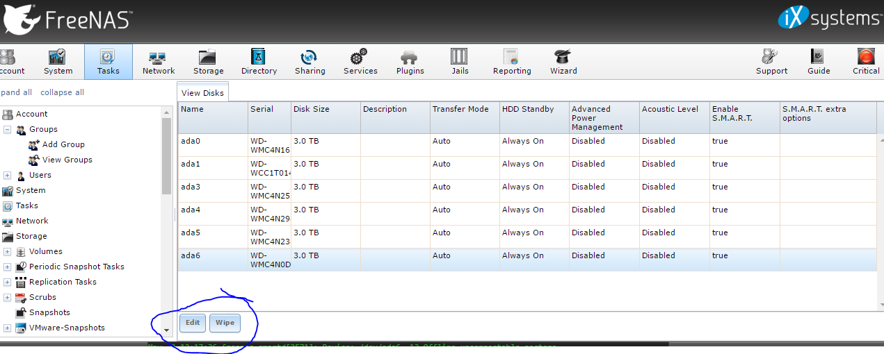

What am I missing here? Why is there no Offline button like the manual / post states? All I see is edit or wipe.

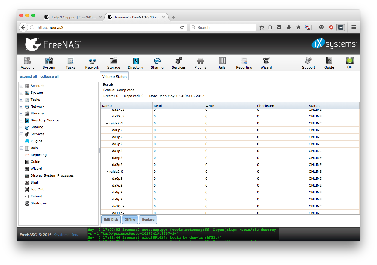

...because you're at the wrong screen. You're at the View Disks screen, and you need to be at the Volume Status screen.
Edit: add screenshot:
Edit 2: ...and the manual (the link Dru posted) does tell you to go to this screen; you don't need to take my word for it. From the text immediately above what she quoted from that page:
Before physically removing the failed device, go to Storage → Volumes → View Volumes. Select the volume’s name. At the bottom of the interface are several icons, one of which is Volume Status. Click the Volume Status icon and locate the failed disk. Then perform these steps:

Well aren't I dumber than a bag of hammers. Thank you. Still need to replace the drive, I think.

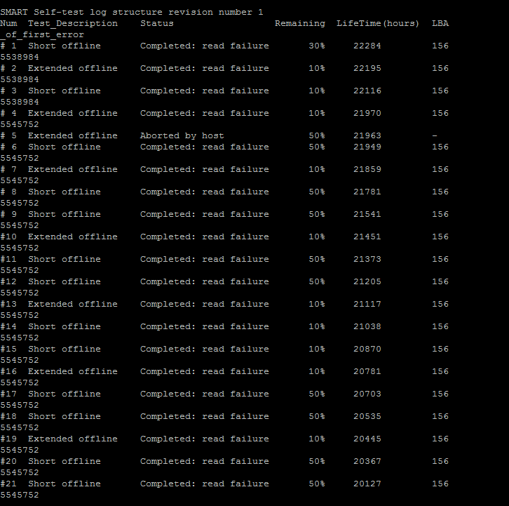

Ok. So the correct syntax for me should be with the following log errors:
Sector Sizes: 512 bytes logical, 4096 bytes physical
dd if=/dev/zero of=/dev/ada6 bs=512 count=8 seek= 1565538984 conv=noerror,sync
I've ordered a replacement drive, but I wanted to figure this out for my own linux growth. (1565538984 /8 = 195692373 (even division by 8)

The options for dd in FreeBSD are not case-sensitive. Linux is, oddly. I don't feel that remapping some new bad blocks is useful. For one, it might overwrite valid data on the drive. A scrub should detect that. The other thing is that when a drive starts growing new bad blocks, it's usually the media going bad, and it doesn't stop.

Your command looks right to me, except you have an extra space after seek=. dd is dangerous, always check that your command is correct and especially that you have a correct count=X to stop it. After you've overwritten the two spots, try another long test.
If it isn't clear after a few rounds, either wipe the whole drive and/or replace the drive.
The next scrub could have a few checksum errors repaired after this process, although in this case it seems unlikely there is actually any ZFS data on those sectors.

Yes, I'd agree. I don't trust the technique of "force remapping the sector by overwriting the bad block"--maybe that's just me being conservative, but SMART test failures call for replacing the drive in my pool.
