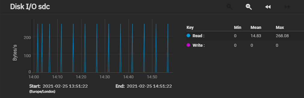

Hi Guys,
Usually the case, when you start looking at stuff in detail, you find shi-uff that might be normal.
I've moved the system datasets to my boot pool and no ix-application datasets so the system should be idle, however, I see small reads every 5 minutes:

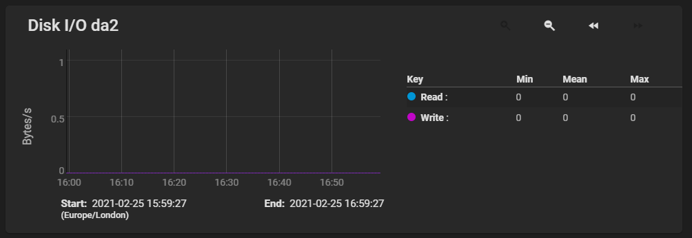

For testing's sack as this is a new pool and new disks, I imported it into core and core doesn't do this:
Does anyone know what this could be? I don't see anything in JIRA or other reports.

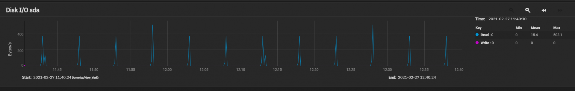

Just wanted to add that I'm having the same issue. I'm getting reads every 5 minutes on my HDD, even after my ix-application datasets and bootpool and system pool have been moved to a separate SSD. I've been trying to track down the process doing it with IOTOP but I'm struggling to pinpoint it.

In my case, it's a SATA HDD that is assigned to a single pool. I don't have any data stored on the pool yet. I am still setting things up.
I tried switching off S.M.A.R.T. under the disk options and it stops the every 5 minutes reads, but it checks it every 30 minutes (wakes the drive up and I see reads getting reported) and I get a notification that S.M.A.R.T isn't functioning on the drive. (Makes sense because I shut it off to test.)
I am trying to figure out how to not have SMARTCTL wake up the drive every 5 minutes. At least, I'm assuming that it's SMARTCTL that is causing it here.
FlangeMonkey
Member
Dec 6, 2012
110
My analysis also points to smart, as I get the same results if I execute a "smartctl --all". However, it does this every 5 minutes with the smart service running or not.
Edit: all disks are SATA HDD, single RAIDZ2 vdev and pool. However different results between Core and Scale.
