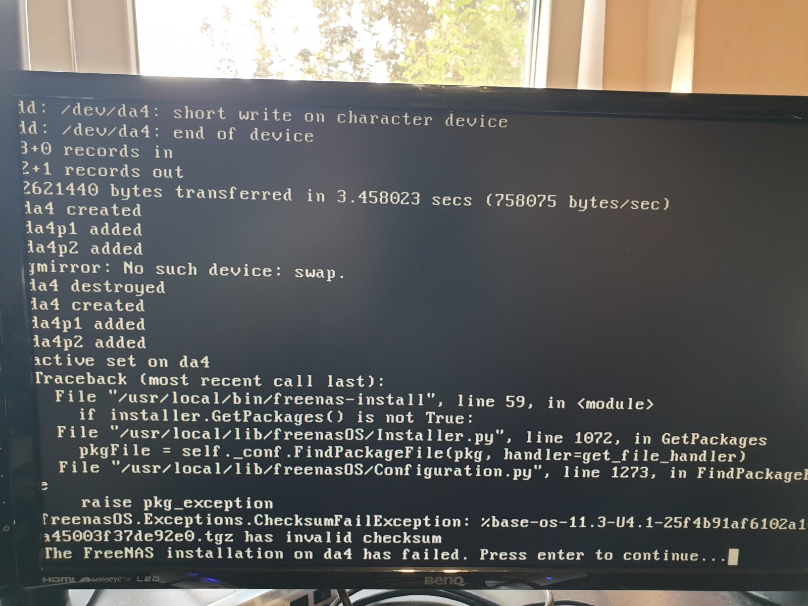

I just installed my first FreeNas, but unfortunately due to some problem (crash) with the SSD where the OS is installed I decided to replace it to an sd card (I don’t have enough big usb laying around to replace it)
I have some problem during install but I was able to resolve it from this post:
https://www.ixsystems.com/community...rror-unable-to-gpt-format-the-disk-da0.60487/
https://ramsgaard.me/freenas-installation-failed-operation-not-permitted
My problem is now I getting the following ERROR MSG:
  1. I used the install media before just for the first installation
  2. I write out the iso to a different SD card
  3. Checked the downloaded ISO checksum
  4. Tried to install to different SD cards
At this point I really don’t know why I have this error.
ebalcsk
Sep 11, 2020
6
Cleaning the memory slot with air solved the issue. (there was no visible dirt in the chassis)
